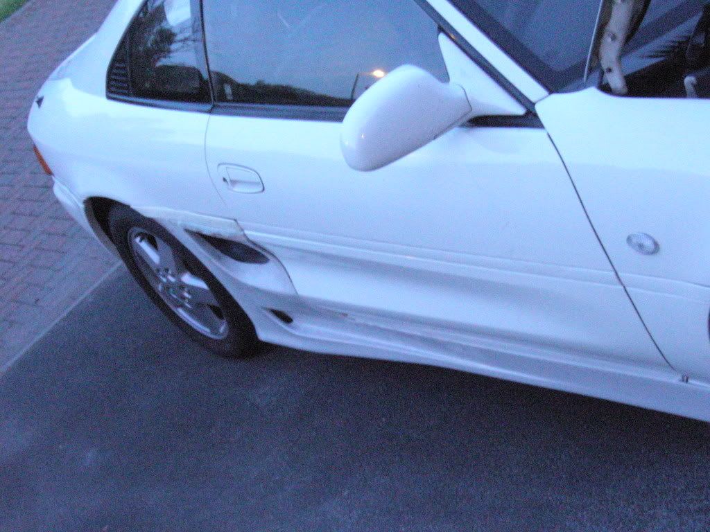

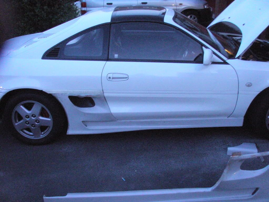

some updated pics....
ive rebuild the lugs holding the skirt under the side strip and filled the gap between the top of the skirt and the side strip......
