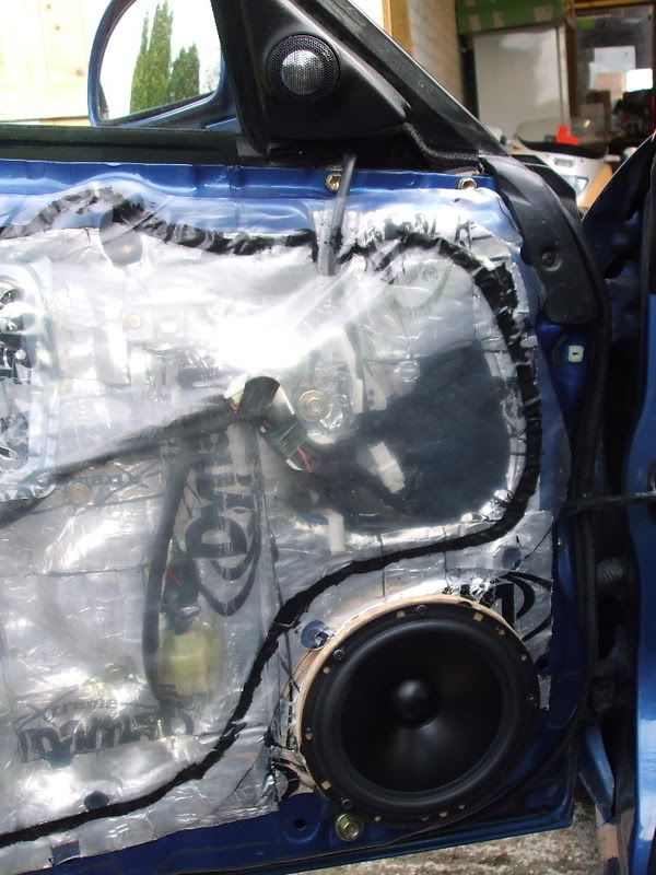

Evening folks,
Over the last couple of days I've been prepping my doors with the labourious task of Dynamatting :| so thought I'd start a post to let you know how the install progress is going :D
I've finished Dynamatting the door skins as you can see. Should I bother doing the rear side of the outer metal part of the doors :?:
When I had my GT4, I covered the door skins & also covered the rear side of the door plastics. Should I bother doing that this time around :?:

Glad to see someone doing things properly, and going to the time and effort to put some decent sound deadening.
If it was me I'd definately do the inside of the outer door skin. I was always taught that you should sound-deaden this part first, as its the biggest sheet of flat metal in the door, and therefore the most prone to vibrations.

Same here. i pulled all the interior out and have placed deadening on the floor, behind the seats. door skins, centre tunnel. even small sections do wonders to dampen noise. and the difference it makes to give decent speakers a solid platform to work from.

I am starting to dynamat my mr2 soon, so it's good to see how others are doing the same thing :D. I have 1 and a half (~5m2) packets of dynamat bought for my project so I think that should be enough...
The progress is looking good here, but I have heard that it would be best to cover all the holes in the door also with dynamat? That would really makes any servicing on the door impossible or very hard atleast so is there really any point in going that way for the extra dampening. I was also thinking about putting some mat on the inside of the door to dampen the outer side of the door also. Does that make any sense to anyone :D.. all comments are welcome ;).

me personally i would of thought that putting dynamat on the door skin wouldn't be that detrimental to the sound i would of though you would get a lot better sound if you where to dynamat behind the dore skin behind the speaker :thumleft: as then the speaker has something to bounch of rather than losing the sound through the dore itself,well this is what i did to my mr2 and it gratefully improved my sounds \:D/ hope this helps you matey :thumleft:

Yeah I'm Dynamatting behind the door speaker today. I should really rip out the whole interior & Dynamat the floor, firewall, rear 1/4 pannels & the doors. But just doing the door well enough will be good enough for me.
I just remember Dynamatting the doors on my GT4 & the places I didn't Dynamat (like the curved section of the door cards where the door lock pops up from) rattled & vibrated & that was with just the JL door speakers in there #-o

Now onto the doors. I bought another roll of Dynamat & covered the areas directly behind the door speakers & along the rest of the door itself.
I had to knock up a couple of spacer rings for the 6.5" door speakers & they're now finally in, but nothing is wired up. The rear of the speaker grill plastic had to be trimmed back to allow for the increased speaker size.
