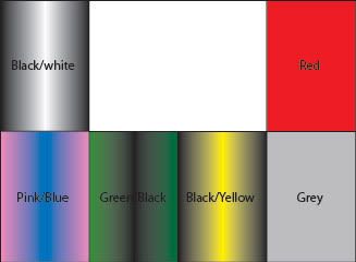

I had a look at the back of my stereo and the pink/blue cable is connected to the blue output from my stereo, however looking at the plug that goes into my aerial I don't have red/white and black wires, instead I have the below:
This is as you look at the plug from the front.
The car is a UK Mk2 Rev 1 NA
Can anyone tell me which wires I need to connect/bridge to make it work please?
Thans for any help ffered

inky wrote:I'm at work right now so can't check but I think, there is the loom that plugs into the aerial. Then there is a smaller loom which goes to the relay. Its on this loom that you need to do the bridge across the red-white and black wires. For some reason this small loom has different colour coded wires in it :?
If I get a chance to check later today I'll update this post.
Thanks, in that case I guess I need to know where the smaller loom is too then :)

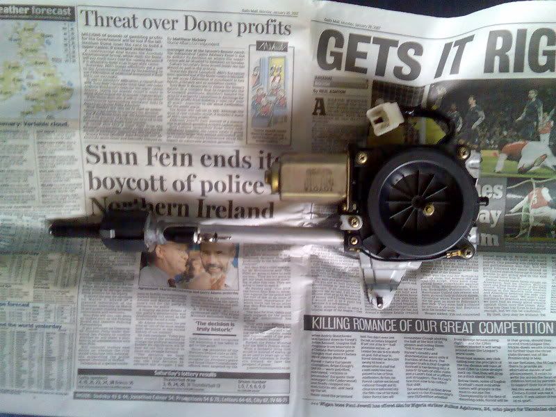

From some old pics when I stripped mine down:
This is what you start with (out of the car obviously). See where the loom is, the white plug, thats where your car's loom connects, from there on its different colours :? That goes to the relay black box on the back of the grey metal frame. You can unplug that piece of loom while the aerial is still in the car but can be fiddly to get back into place as you're working blind.
Anyway thats the little wiring loom that needs the bridge doing :thumleft:

inky wrote:From some old pics when I stripped mine down:
Image Replaced With URL For Quote http://i69.photobucket.com/albums/i78/d ... /start.jpg
