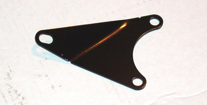

Any chance of some pictures of this bracket as msherry hasn't replied to my pm.

vipernet55 wrote:Any chance of some pictures of this bracket as msherry hasn't replied to my pm.
Should look something like this

SUPPORT BRACKET, SUPPORT BRACKET & SUPPORT BRACKET.
You must make sure its fitted with your down pipe or else its very likely to crack no matter what make it is :roll:

Any idea why this is so?
Daveb
Posts: 423
Joined: Fri Dec 31, 2004 9:08 pm
Location: Fife, Scotland
Re: [Mk2 Turbo] Cracked Aussie Downpipe with Pictures!!!!
Post by Daveb »
Lot of weight on the downpipe and turbo without it.
