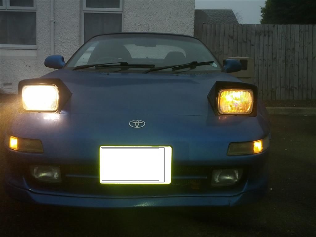

if the biblical rain stops I'll give that a try. It worked fine when I left work to drive to the petrol station. Then when i turned the lights back on again, dull on the passenger side again!
looks like this, forgot I'd taken a photo

I thought I'd have a go at this tonight, so I quickly pulled over and whipped out the Left headlight 15A fuse... hey presto, exactly the same result:
