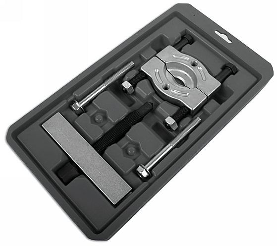

Do NOT use brute force to remove a wheel if it's stuck!!!! I learned this the hard way following intwernet write-ups and had a frozen shoulder for ages afterwards.
You should use a pulley puller (yahoo it) or go into a motor factors. On a rev 2 wheel at least once you pop the plastic centre part off you then unscrew the central nut until it's just about off the threads. You should see two tapped holes either side of that (M6 or M8) -few inches out from either side of the central steering column shaft. You put your puller on and screw the securing bolts through those holes. The main shaft on the column sould have a centre dimple, screw in the main puller bolt and locate the point on the dimple of the shaft and use a ratchet or spanner to tighten against that. It'll pop-off in a few seconds.
....Just saying this as mine was absolutely stuck (not the first person to find this) and I can't believe how much pain I was in after the "unscrew and jerk" method written up on internet -not to mention potential column damage. Probably spent more in pain killers for weeks than the cost of a puller in the first place. I found there's tapped holes on the wheel for a reason so use them and I've used the puller since anyway so was worth it.

I think the correct way to do it is to use a puller -and any other method seen is at own risk. Taps from a mallet on the rear of the wheel on mine did nothing. Like I say I followed the forum "unscrew and jerk" instructions as I was doing it for the first time -it's quite clearly not right and once bitten very much twice shy. Changed a few wheels since and the proper puller makes light work of it. You don't have to make a tool, it's already there...
I use the bottom left bar and associated bolts in this kit to pull wheels and pulleys etc off shafts...
http://www.lasertools.co.uk/item.aspx?cat=496&item=1123
...sometimes you need different bolts to fit the threads in the parts but hey ho. The "break your nose" comments (not just this forum) aren't really valid when you do it right there's no risk whatsoever.
