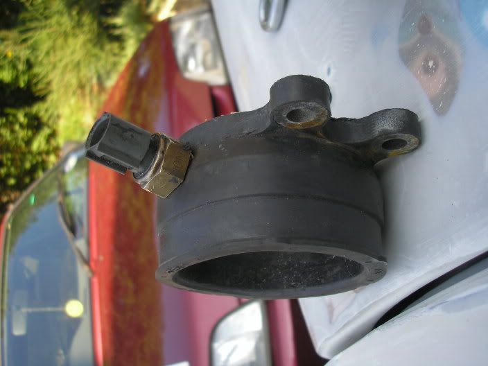

Hi nath
i did a guide on how to stop heat soak on mat sensor, Basically just relocate the the sensor into some of the intercooler pipe, i fitted mine into my st205 sock.
The thread for a locking nut is i think 14 x 1.5 which you will have to use to hold sensor is place on the inside on piping but make sure you thread lock on to stop nut coming loose
See here the rubber insulates the heat away unlike the alu does in inlet manifold

so could this be the reason i'm still seeing my 44deg intake temps?

check your boot temperature as well to make sure you are getting cool air through the intercooler. Failing that buy a cheap multimeter with temp reader from Maplin and get a thermocouple under the throttle sock. That way you'll know what temps you are actually getting.

Thermocouple was showing 35degrees on nathans on the road, whilst the MAT sensor was showing 62deg.
