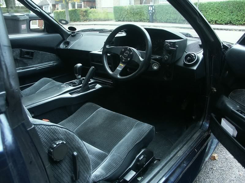

Hi - sorry I've taken a while to reply! If you're still interested I still have the boss. I bought it from Halfords where the guy told me it was a Mountney, but I can't see any markings on it. It should fit pretty much any aftermarket wheel; it certainly did the job with my Momo Corse, and I had no problems with indicators failing to cancel.
As for "fitments", there are none; screws to attach the wheel to the boss should come with the wheel (if not, they're readily available), and you use the car's original nut to attach the boss to the steering column.

Personally I like the 320mm wheel (same size as in an Elise, BTW). Really enhances the 'go-kart' driving experience. Although, I have to admit that it makes for a good biceps workout at parking speeds - especially with 205s on the front!
The 320mm Momo Corse I had in one of my cars was slightly offset upwards, which meant I had no problems with instrument visibility. A wheel of that size (or smaller) that isn't offset will, unless you're really short, partially obscure the tops of the tacho and speedo dials, which is the problem I had with my other MR2.
