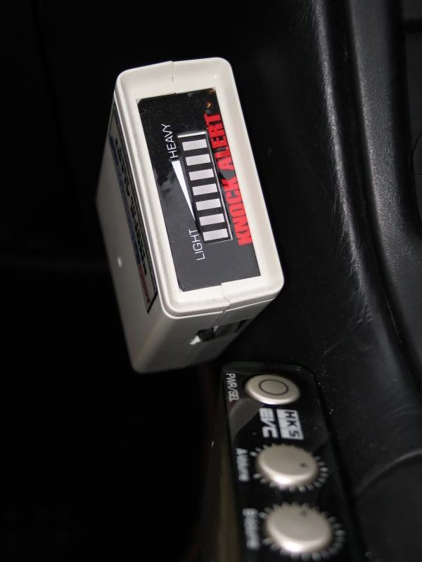

I have a permenantly fitted det gauge in my car. Probably one of the best bits of kit Ive had fitted. It detects even tiny amounts of det and let you know how serious it is. Excellent for changing ambient temperature. The tuner uses it along with det cans and a lamda sensor.

llenrub wrote:I have a permenantly fitted det gauge in my car. Probably one of the best bits of kit Ive had fitted. It detects even tiny amounts of det and let you know how serious it is. Excellent for changing ambient temperature. The tuner uses it along with det cans and a lamda sensor.
you got a pic of that mate? how does it give you a reading or is it just that it can tell if it is in det or not?
is this what is know as a knock meter or something completely different? :oops:

The one I have does not give you reading in that sense. It has a line of LEDs going from very light to heavy from green through yellow to red. It also gives an audible warning too. It looks similar to a Fuel/Air Gauge. It certainly helps you find your cars peak boost level for the prevailing conditions!
I wish I had it last year. I wouldnt have blown the last engine !!!

i have a knock allert too, have to say looks better painted black

Hey llenrub or AM Tuning or anyone else, where did you get those knock alert instruments from and what was the price? I presume you wire them in series between the knock sensor and the ECU or something?

i bought mine second hand from the usa ,,, they come with there own knock sensor too
have u look at usa sites im sure u will find one
