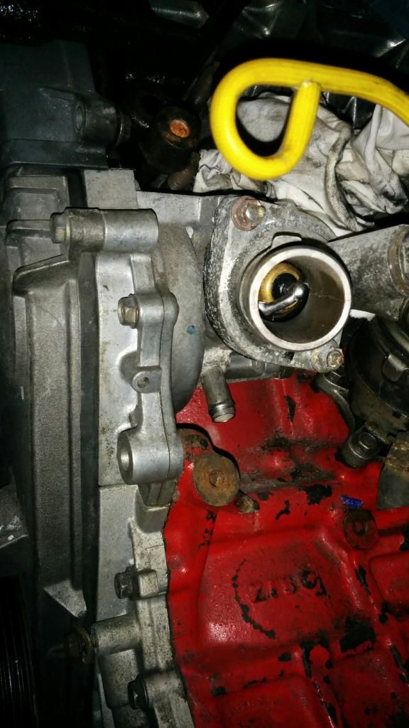

ashley wrote:sheppy wrote:Yeah what's this problem? I'm by no means doubting anyone but 9 years on this site and i've never heard anything about this, if anything i'm slightly worried as my tensioner is off as it rattled itself free
It is based on speculation between a couple engine builders I was discussing the 3S blocks with..
.we understand why the Rev3+ blocks crack in the cylinders
(poor casting, and hence inconsistent cylinder wall thickness, proven across 4 dissected blocks).
We also understand why sleeving them doesn't solve it as there is too little material left between the cylinders to resist the forces from the crank,
(and so the deck tends to crack into the top water way, typically between 2
& 3).
The history we as a group had pointed at rev 1- 2 blocks having thicker, more consistent cylinder walls, but when they let go it was almost always around the water pump casting.
One of the speculated causes was that when the a/c was deleted on these engines, often the a/c tensioner bolt wasn't replaced into the water housing, the theory being that centrifugal forces in that area of the block without the additional support from this bolt may have been helping lead to cracking.
It's certainly no where near a proven fact, just our best guess as we tried to explain the patterns in front of us and I'm kinda regretting putting it out there now..
.expecting to get told I'm wrong!
I'm glad you put it out there!
Just went and checked mine:
No Bolt there
Cheers

Regarding bolt, is this a rev1/2 only thing, or effect rev3+ too?
It sounded like it's only
'potentially' an issue on rev1/2?
No a/c on mine, so I imagine no bolt too, worth fitting one anyway even though I'm on a gen3?
Ps, this topic maybe needs moving out this thread??

jimGTS wrote:Regarding bolt, is this a rev1/2 only thing, or effect rev3+ too?
It sounded like it's only'potentially' an issue on rev1/2?
I agree, this is deffo something that needs discussed in a new topic, I certainly would like more info regarding it, my aircon pulley rattled itself free
The bolt is there on all revisions.
Non AC engines just have a shorter bolt.

BTWW wrote:jimGTS wrote:Regarding bolt, is this a rev1/2 only thing, or effect rev3+ too?
i know the bolt is there, im asking if its an issue

The pattern of failures that I am aware of
(so very incomplete) suggests that it is a rev 1-2 issue, the casting on rev3+ engines is different, and I am unaware of a pattern of failures around the water pump on later blocks

well, what the hey, bolt was missing on mine, so i just fit one for the hell of it, gen3 engine and all.
