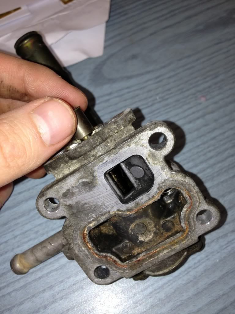

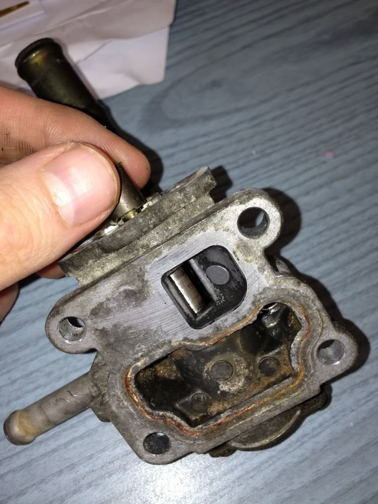

Took all my throttle body off to clean it as cars been standing a long time. Can someone tell me of the part in the pics should be tight to open or very very lose to open. Cheers
That looks like the idle control vavle, and as such, should be a nice smooth action. If it's tight the engine will struggle to idle at the correct speed when cold.
