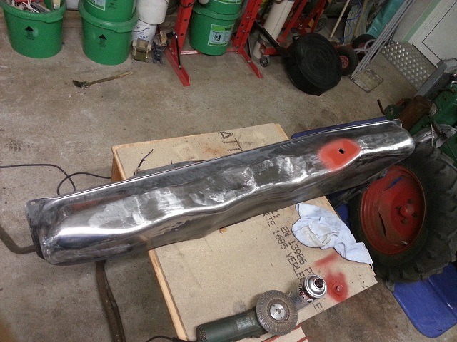

As the fuel pump didn´t survived the time I will have to change it.
Not such a big thing as I still have the stock pump of my Celica
(where it was replaced by a Supra pump) but to change it the fuel tank have to come out of the car.
The tank in the car is a bit rusty but I´ve kept the one of the donor car which is better but not perfect.
So I´ll swap tank but before the
"new" tank have to be refurbished.
So I steelbrushed the undersite of the tank:
treated it with Fertan rust converter and primered it.

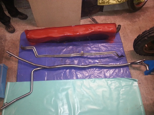

Did the same to the water pipes of the donor car as the pipes under my MR2 are rusted too:

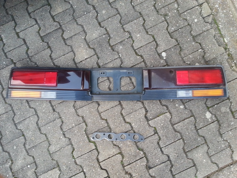

Been shopping through the internet the last weekend.
Yesterday the first items arrived.
A used set of JDM tail lights in exellent condition and exaust manifold flange to build a custom four branch exaust manifold from Paul Woods:

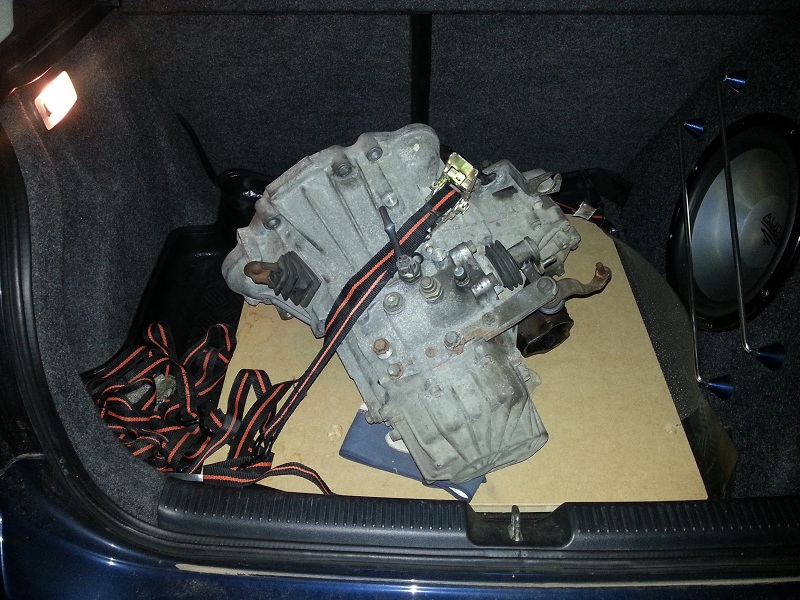

Also made a very good deal on german eBay, a 6 speed gearbox out of a 99 Corolla E11 G6 for 50
I will to pick up from Luxembourg:
http://www.ebay.de/itm/160970483414?ssP ... 1423.l2649

Just so you are aware, the gear linkage assembly on that is on the wrong side for use in an AW11, you will need a Celica 6 speed centre case and selector assembly to make that work, sadly the centre case from the C52 won't work either, the selector detent is wrong for the 6 speed assembly.
I can source the parts you need though if you still buy it.
Re: My AW11 Fritzinger widebody. Some years of work in pictures
I know that the linkage is on the wrong side.
Thought I can drill the box housing and use the MR2´s linkage than folloing a guide to convert a 5 speed Corolla LSD I´ve found on the web.
Please make me an offer for the parts I´ll need if You´ve got them,
Paul.

Yes you can drill the casing, but it needs to be spot on and you need to install an oil seal as well, i only tried this method once and while it worked it wasn't ideal.
The 5 speed selector shaft is no good, unless you have it properly welded to the 6 speed assembly, then it will work, but again it needs to be perfectly straight.
I'll see what i can do on the parts if you still want to go that way,it really takes the pain out of the conversion to 6 speed.

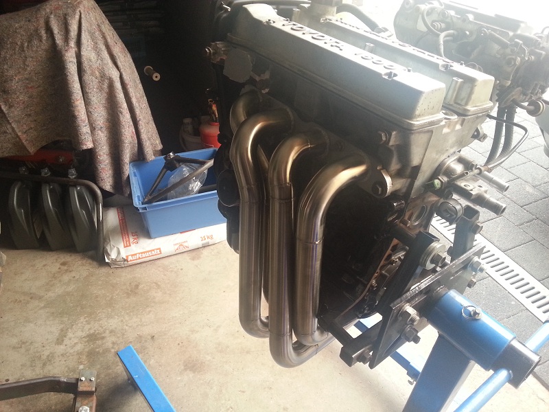

Spend some money again today.
Picked up my engine from the metalworker who builded the custom exaust manifold out of the flange I´ve bought from Paul:
Later I drove to Luxemburg to pick up the 99 Corolla 6speed gearbox I´ve shooted at eBay at a embarrassing price of 50

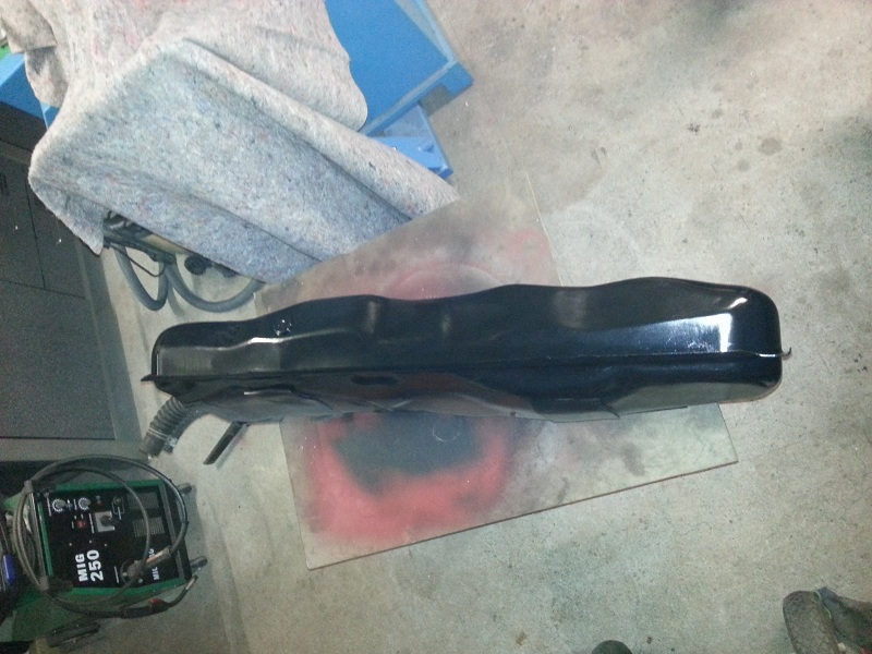

Painted the fuel tank black and the cooling and heater pipes silver:

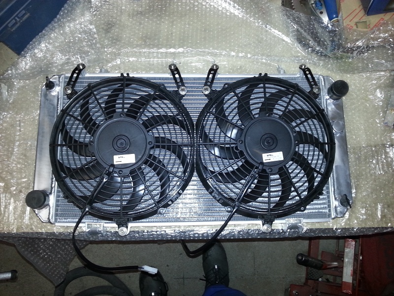

And I´ve fitted the Spal fans
( aka
"windmachines" as they move 1650 m³ air per hour) to the alu radiator using universal brackets from Spal:
