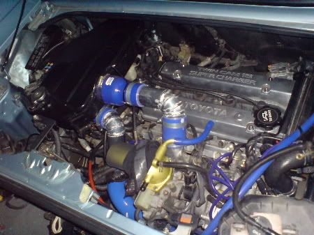

Here's my setup
Note, the battery was rotated 90 degrees so I could fit the Legacy CC in. Excuse the 'air filter' :oops:

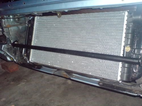

This is the Cinq rad that I had fit infront of the engine rad. I used some standard heater hosing and a 700l/hr pump. Seems to work OK but I havent really given it much stick. Yet.

Here's mine - also from a Subaru Legacy. On mine the battery has been relocated to the frunk, so there was plenty of room for the cc core
Piped up
