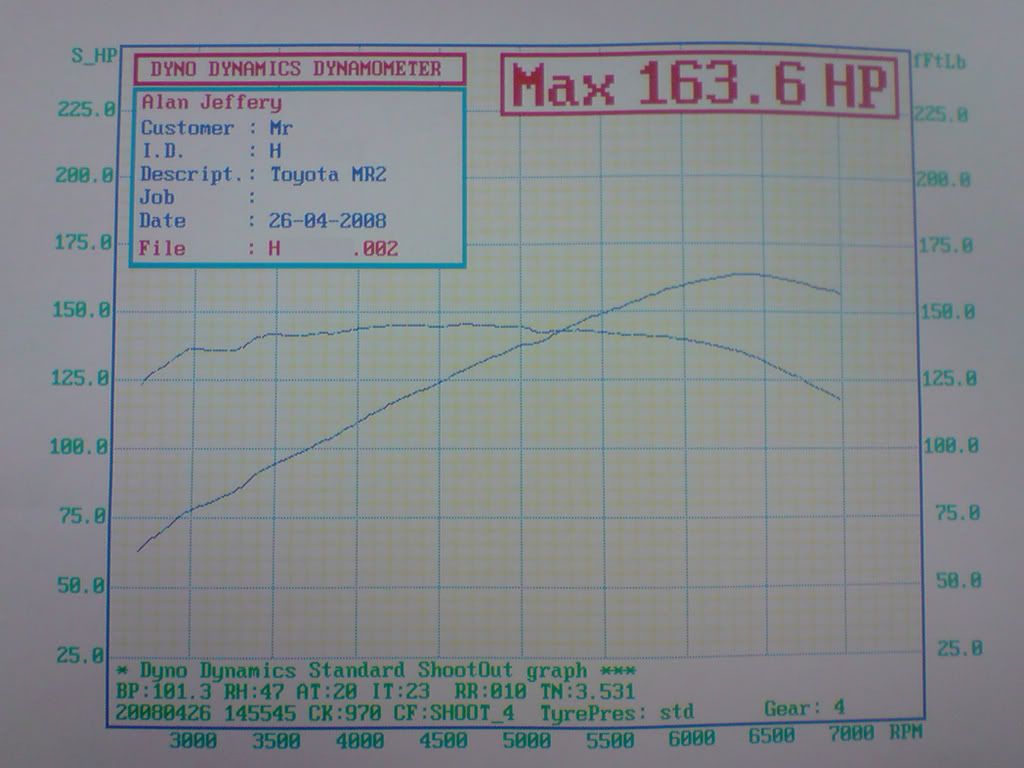

I've been busy this weekend trying to figure things out, I took a trip home to Plymouth this weekend and went to some of the garages I've used in the past when I was living there.
First stop was to get my tyres checked. I'm noticing SIGNIFICANT steering vibration at around 70 mph which just gets worse from there on. I had asked for a full balance and tracking check on the car, and basically the guy instantly told me that this wouldn't solve it. The cheap ass tyres on the standard 14" rims have uneven tread! Oh well, I'm getting new rims anyway, I'll try and get some today I thought!
Then off to their next door neighbours to find out what part of my exhaust is blowing, a quick check from the guy and he tells me it's the flexi pipe that's gone. OK so now I know which bit, next question, which I put to you guys, is when replacing the system, can I get a performance upgrade to the flexi-pipe or do I need to have that pipe no matter what?
After this I popped over to Alan Jeffrey's to get my car on the Dyno, to basically get a baseline power curve for the car before I change I single thing. He was busy with a Dyno day so I had to come back later. Off to Halfrauds I trundled to see what rims they had in stock etc. After a brief chat with the guy, I quickly find out I'm not going to leave any establishment with rims that day! So he gives me a pointer to Rare Rims based in Collumpton who carry Rota rims in stock, I'm waiting to hear back from them on the availability on TE37-a-likes with a 7" front and 8" rear setup.
You guys recommended the staggered fitment, but you didn't say how difficult it was going to be to actually get them! ROFL.
After this, I mosied on back to the Alan Jeffrey's, they got the car on the ramp, and I waited with a friend outside the booth (they have a seperate screen setup for 'audiences') hoping for an ok result. The first run came out and I was a little gobsmacked to be honest. I thought mine had a standard figure of 156-158bhp but the guy said that the UK spec one had 164bhp standard. OK I said, then the second run came through....
163.6 BHP!
I was quite pleased with this! Although I'm still a little scepticle. He said it's the closest to spec bhp he's ever seen on a standard NA!
I will upload the graph later on for your perusal, however there are some things to note about it:
- I was running 97 RON fuel at the time
- The exhaust is blowing quite a bit, I'm not sure if this is contributing or not.
- The ATW figure was (I think) 101.3 if I'm reading the graph right. Does 60 brake loss sound about right?

And here's the graph :)

A difference of 62bhp between the fly and wheels sounds a lot to me, some dyno, some places just guess this others calculate it by letting the rollers bring the car to a standstill. Sounds like they might have just guessed this using a standard formula which does not take into accounts the mr2’s lower than average transmission loses.
I would have thought about a 40bhp difference is more likely.
All other plans sounds good and look forward to reading about the updates. I am also fairly sure rev 1 and 2 cars only have 254 and 258 bhp depending on if they have a cat fitted or not.
Alex B
Re: [Mk2] [NA] New to the MR2 World - My Mr. Two Track Car Project
Post by Alex B »
Mikey P MR2 wrote:A difference of 62bhp between the fly and wheels sounds a lot to me, some dyno, some places just guess this others calculate it by letting the rollers bring the car to a standstill. Sounds like they might have just guessed this using a standard formula which does not take into accounts the mr2’s lower than average transmission loses.
This is what I thought also. I didn't pay enough attention to know if he'd let it come to rest properly or not. If anyone who knows about Dyno Dynamics Dynos is reading; from the graph do any of the numbers at the bottom represent the loss figures at all?
Mikey P MR2 wrote:All other plans sounds good and look forward to reading about the updates. I am also fairly sure rev 1 and 2 cars only have 254 and 258 bhp depending on if they have a cat fitted or not.
I'll assume you meant 154 and and 158 respectively ;)
