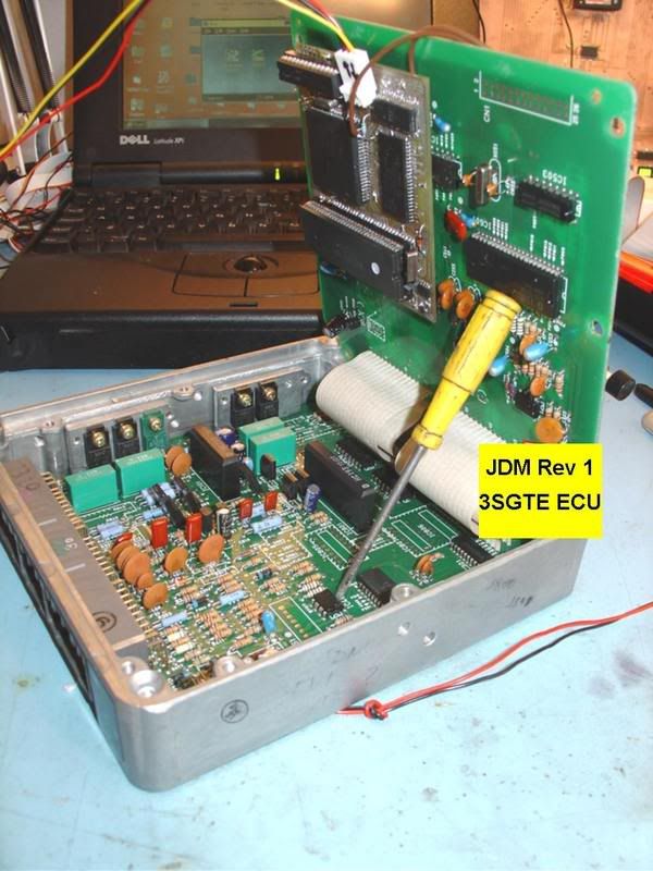

I've designed and built a reflashable ROM board for the 3SGTE ECU and I need a local MR2 owner to test it with a quick drive up the road.
It's been fitted to a rev1 ECU and I've been able to test the ECU on a jig that simulates a real MR2 and it seems to drive just like a stock ECU.
It has the factory datalogger system built in and can be reflashed via a laptop for new maps or even a new ROM program.
It's a bit like a Techtom board only it has datalogging and it can be reflashed via a serial cable (no chips to swap)
Is there anyone (brave) near Cheltenham willing to try it?
I'm pretty sure it will drive just like stock as I can monitor it on the jig and it datalogs the fuel and ignition just like stock. Also the knock sensor and fuel cuts and boost cut all work as stock.
Assuming it works it means an end to speed limiters, fuel cuts and boost limits etc. Also full access to all the maps in the ECU and stuff like the TVIS and rev limiter.
If no one is brave enough I'll fit it to a UK NA mk2 MR2 ECU and ask again. It should fit all Toyota ECUs with the same MCU chip as the mk2 MR2.
I've also got a reprog board fitted to a JDM mk1 MR2 SC ECU if anyone local wants to test it...

The stock ECU is limited to 16kb of code/maps for the rev2 but my system doubles the memory to 32kb with another 8kb section (and another one at 16kb) for the maps so codespace is not a problem.
So I could add stuff to the factory code to do with boost control or simply modify the maps that are already in the ECU.
I've only been looking at this ECU closely for a few weeks but I have reverse engineered most of the code so I know where the maps are, and also how the knock code works and also a fair bit about the closed loop fuelling.
Also I take advantage of the hidden factory databus inside the ECU to grant me low level access to the inner workings of the ECU MCU chip. This allows datalogging of 'everything' eg sensors and rpm and efi and ign timing right down to logging the internal timers that add a delay trigger to things like the speed limiter or TVIS etc. Or I can look at the logic levels on the chips pins via the datalogging or I can even watch the MCU stack or internal 16bit timer in real time. It is possible to datalog the knock self learning and see how much fuel and ign retard is being added during knock. Also the closed loop fuel learning and the 02 sensor status.
The way I've arranged the hardware means the code can be upgraded at anytime in the future. The 32kb is a total blank canvas so the whole ECU code coud be changed with a simple laptop upload.
I think I need to learn more about boost and boost controllers... :)
BTW the ECU will not look standard with this board fitted. I have to raise the lid height with a spacer. I could make a more tailored/discreet board but it would not be as universal as this one.

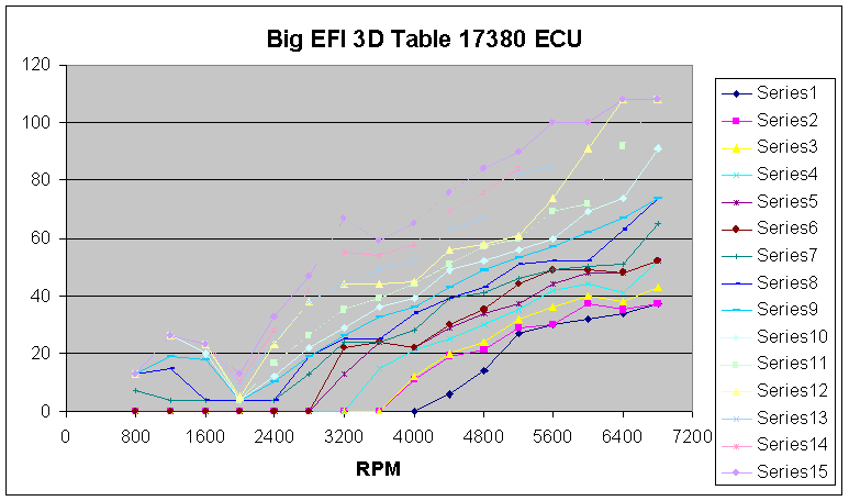

eg here's the main fuel correction map in a JDM rev2. each curve is for increasing boost and you can see how much control you have. Much better than a Unichip. You could soon remove overfuelling with this map.
Each dot is a map value in a table and you can move each dot up and down with the GUI. EG you could have crazy zig zag rollercoaster fuelling if you wanted :clown:
screech205
