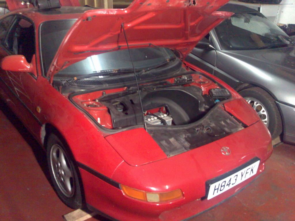

6th february- a day ill never forget!my mate bought his civic, with an mot service history everythin workin and i bought my 2 with a busted 120amp fuse,windows down, no test of electrics or engine or anything really and all it looked was very hot, no rust at all on most of her and a bit of tread on the tyres and a hot looking engine
and more shades of red than a bumper crayola pack

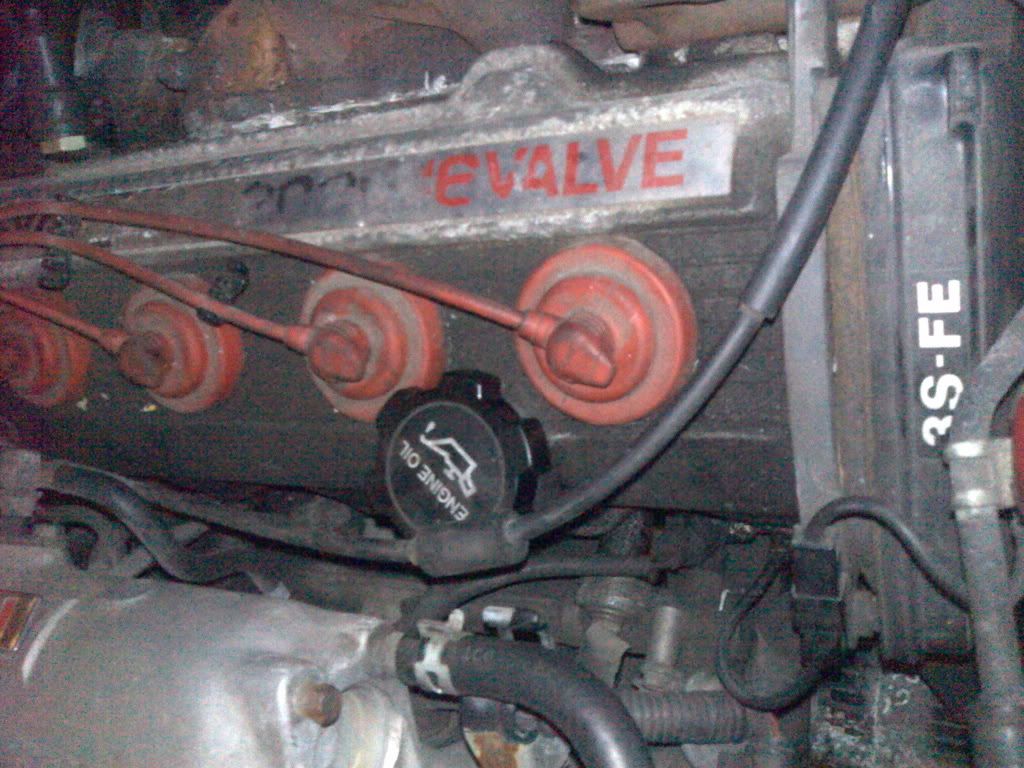

- the engine!! so i seeked some mr2 wisdom and i have johnm400 and paul@woodsport for this as well as my mates! we all kinda thought the Cobra stickers on the car might indicate an old immobiliser stoppin the engine from starting.
.the guy had put on a starter button and didnt really know too much!so i got the starter relay out and plugged in two nails into the relevant sockets and then chugchugchug of the starter motor and WOW can u believe it!!it was 930,my mate was inside watchin tv in his dressing gown(he is a very fat guy, sits about a lot!) and i ran and nearly smashed his window with excitement!!
so then it was all about trying to get the engine firing.
.so the imoc guys suggested the removal of the immobiliser what we all kinda thot!so i followed the wire in and found the Cobra box and this is what we did.
so with the cobra mauled heheheh which was fun like really we kicked it about the lawn and stomped on it and u remember when i sed my mate was fat!! so then i got my old soldering kit from physics and burnt my hand 3 times and then soldered the old toyota wires back.
there was a red one a brown ad black one and a thick white one.
i did them all and still nothing.
at this stage i had a week and was running out of time.
.all the effort could be wasted.
then i took apart the wires, cut off a we chunk off the white wire where the old immobilser wire cut in and then resoldered again.
i then asked the eg civic mate to try the button just to hear the starter motor, and he refused
"in case something happens", we argued for 5mins and then i pushed it seeing a yellow fan symbol on the speedo/dash bit.oblivious to that, the engine started BRMMMMMMMMMM and i went AHHHHHHHHHHHHHH and woke up the fat mate and his mum with the sound of my 2l!!!sorry

.im a bit of a traitor but heres the best pic of her
