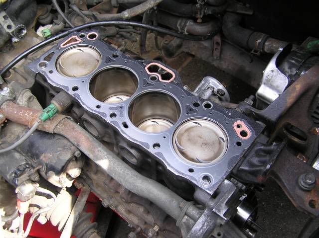

hello ha everyone me cars done and on tuesday morning they turn the key
but we have one problem
we have on electrical connector that is not connected and cannot find what it goes to -- green with a single pin off the main loon fron the ecu
we not longer have the intake pipe did it have a sensor on it? we are not sure please have quick look at tell me where it should go
also it it was on the itake pipe o we need it?
here is a pic of the connector
it is on loom under the throttle contol and sc intake
i am hoping it is just a spare one?
cheers guys and gals

Just had a look on mine - it looks like that wire goes off under the throttle body somewhere, but I can't see where it ends up :(
pistol supercharged pete
Re: please help a sc owner
Post by pistol supercharged pete »
doh is it connecte or does it fell loose
cheers for looking
MartG
Posts: 6029
Post by MartG »
Feels taut - I think it is connected to something. Given its a single wire my guess is its a sensor of some kind - maybe knock sensor ?

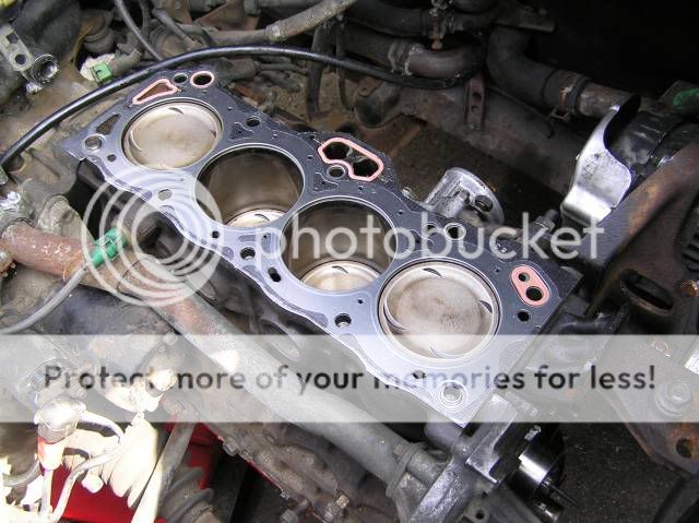

If this is it, it is the knock sensor Pete:

My bet is on the knock sensor, it will definately throw codes and put the engine MIL light on without it. There aren't many connectors round there for it to be to be honest.

Icsunonove wrote:If this is it, it is the knock sensor Pete:
Image Replaced With URL For Quote http://url.photobucket.com/albums/v284/ ... fitted.jpg
That looks like the one pete's after!

chatted to them today and
knock sensor and temp sender defiantly connected
hmm strange will investigate further and see what errors it comes up with mot is tuesday:)
