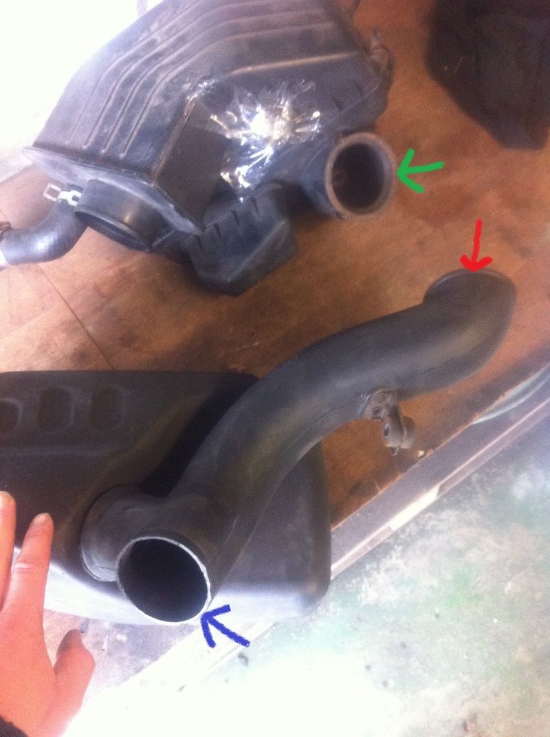

I'm trying to put my Mr2 back to standard, previous owner had aftermarket Bov and Induction cone filter. I have the Bov back on, but I'm trying to fit a standard oem airbox which is in the pic below. I think i'm missing some hoses for the air reisivor section? Also I don't know what connects where in regards to the red, green and blue arrows in my picture. Can anyone tell me, or even better provide a pic to the hoses I'm missing, etc...
Am I correct in thinking that one of either the red arrow or the blue arrow ends doesn't have a hose connected to it and is left open to let air in?

hi mate, just popped down to my garage to take a few pics hope they help you out. I think you've got everything needed doesnt look like there are any missing pipes. You just have to arrange them as shown in my pics:

Hope this helps

@Psummers + auzzam - Thanks alot for that info and for taking the time to get pics, managed to get it all fitted in there earlier today now that I knew in advance where everything went.
