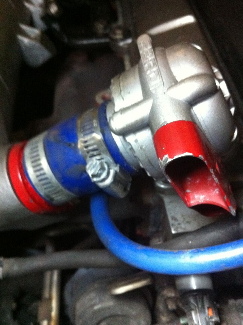

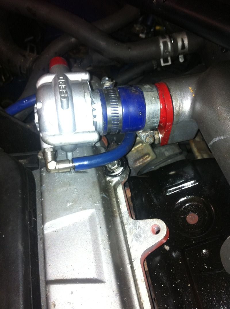

The car has an aftermarket blow off valve fitted by a previous owner. I put a picture up, Is this venting to atmosphere? I think I'll try and put this back to the stock recirculating setup in case its having an effect on the Afm.
cooper514
Posts: 98
Joined: Mon Jun 03, 2013 10:46 pm
Re: Running rich and still failing emissions with new Lambda + Cat
Post by cooper514 »
Never seen 1 of those before but yer its venting to atmosphere and lowering the idle depending on what it's idling at now will help lower emissions as been there on my friends beast to scrap it through he's was a combination of bad lamba lowered it and lowering the idle remove the hydro carbons quite abit if

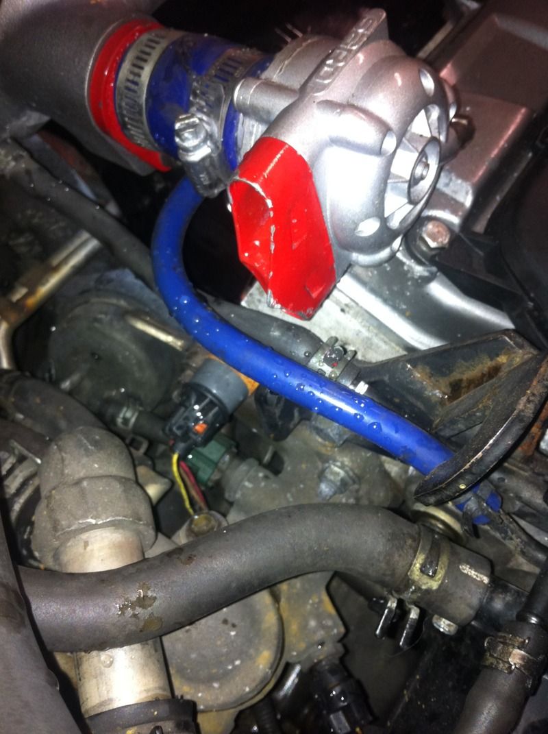

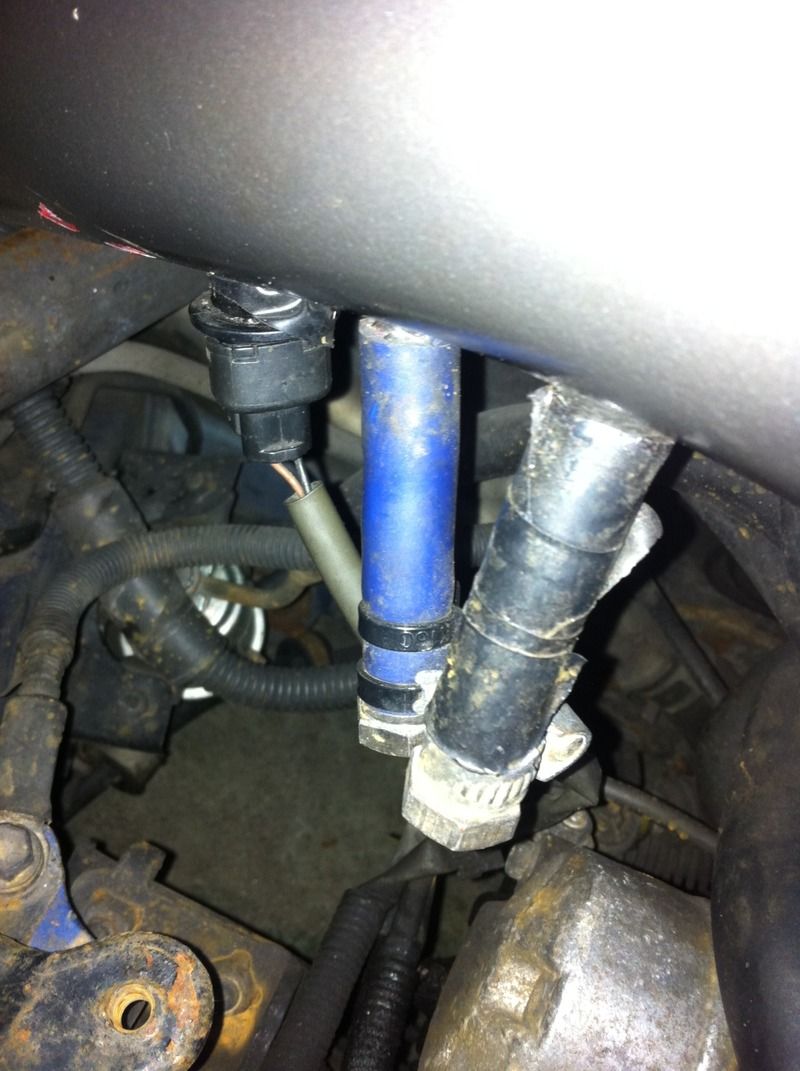

That Blow off valve yoke is a "Sard" make but theres litlte rips in the hose and the connections and plugged hoses going into the cone filter induction pipe don't look great which is why I'm trying to find standard parts to put the car back to standard.
Heres pics of the blow off valve rips and the plugs intake pipes.

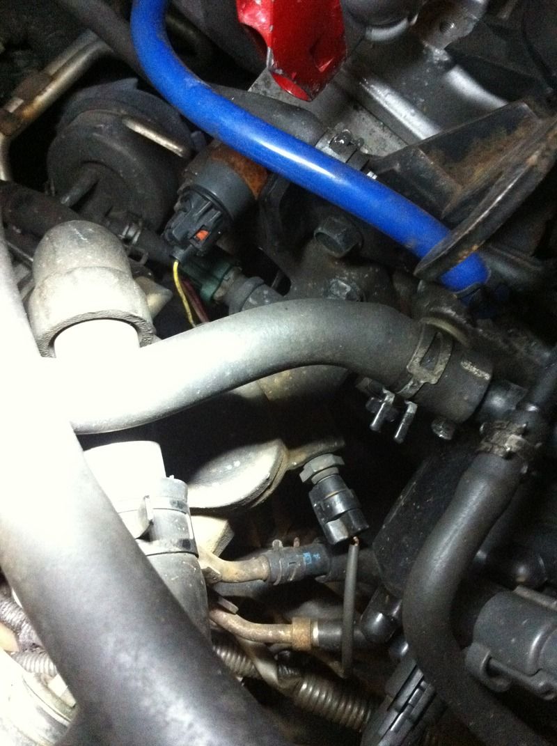

Is the coolant sensor in this pic, is that it with the single wire?

From memory there's 2 temperature sensors one for the guage and another for the ecu, the single wire is the guage iirc earth it and if the guage goes to max then you know.
Id trace the o2 sensor wire back to the ecu to and use the ox pin in the diag port to check it's working correctly

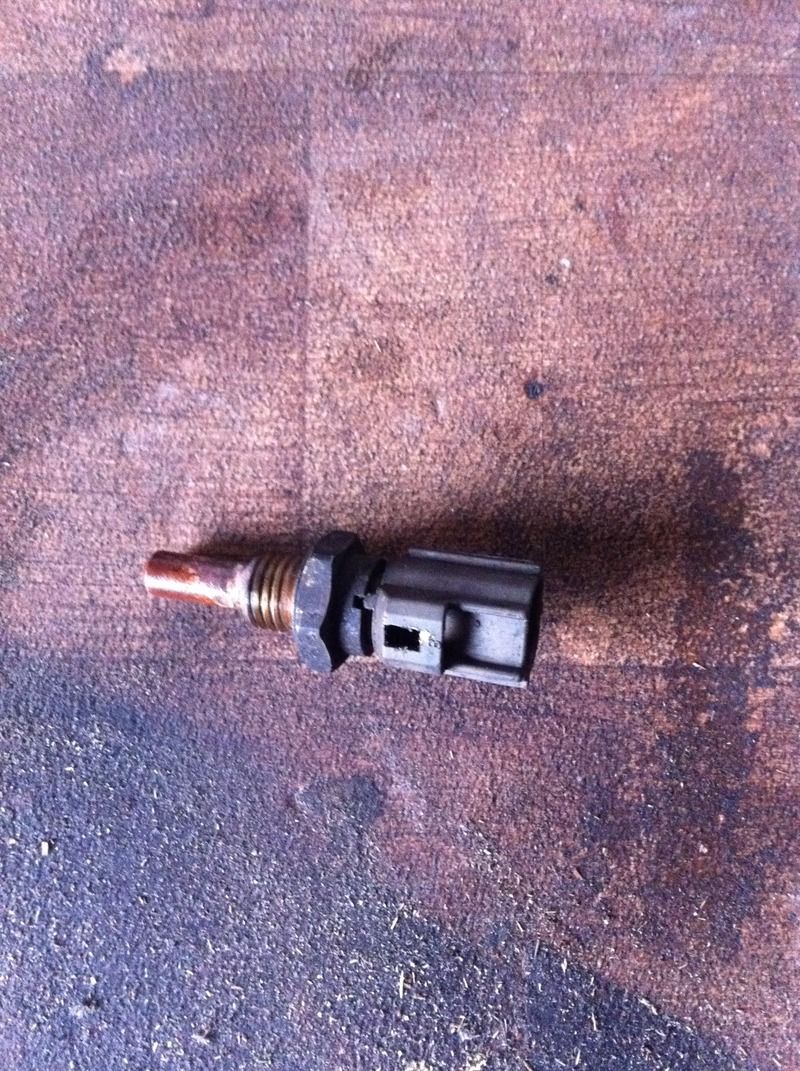

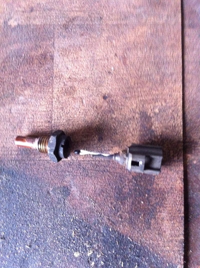

I removed the coolant temp sensor for the Ecu today. The electrical part had corroded and separated itself from the sensor but the wires insode were still intact. Could this sensor have being giving false readings to the Ecu in this state or would it have still worked normally?
Pics below:
