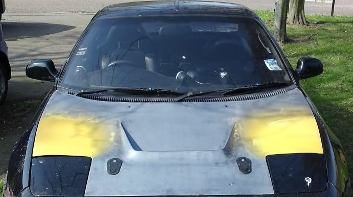

I fitted mine slightly higher up, just so that the fixing bolts could go through a couple of factory holes under the plastic shroud. Cutting out for the aerocatches can take a while - I made a template and then stuck a square of paper onto the bonnet with masking tape, traced around the template onto the paper and jigsawed/drilled out the shape of the catch (the paper is to prevent jigsaw from scratching the bonnet).
You're best to mount the fixing bolts and then put a dab of tip-ex or similar on the ends, then gently lower the bonnet onto them - leaving a corresponding splodge so you know where the catches need to placed :thumleft:
I'll get a pic of the underside tomorrow but it's the same as Craig's posted really. Here's an outside photo, not the best angle but you get the idea!
Re: Bonnet Aero Catches
Looking good there mate!
Mine are where they are, as the pins are mounted to the stock radiator brackets. :thumleft:
