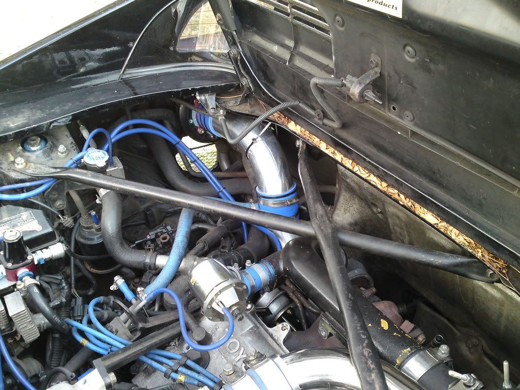

Filler neck bracket .. theres a handy bolt hole....

that looks very neat 2mad :clap: Is that a standard turbo in there just relocated filter and custom intake pipe?

I am blind where am i looking at on that picture?

And i like that filter shield.. Might have a go at something like that myself.

If you follow the blue vac hoses to the filler-neck from the turbo , my evc soleniod is there (its black so not easy to see)
Turbos a ct20b and the intake was me having a macgyver moment .. actually worked well :D
Cheers for the comments.

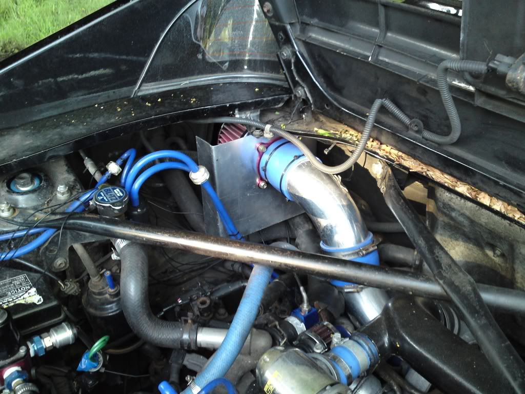

Found an older pic with my greddy solenoid ... right next to the water filler-cap.

I've recently mounted mine on a small bracket mounted to the bulkhead to cabin. But the solution 2mad has posted looks far easier to get to, God damn my huge charge cooler getting in the way.

right got ya. I'll get a little bracket made for it so it will fit.
I quite like the idea of getting a little plastic electronic box and mounting it there just drill some holes in it for the hoses. Keep it lovely and dry. :thumleft:
