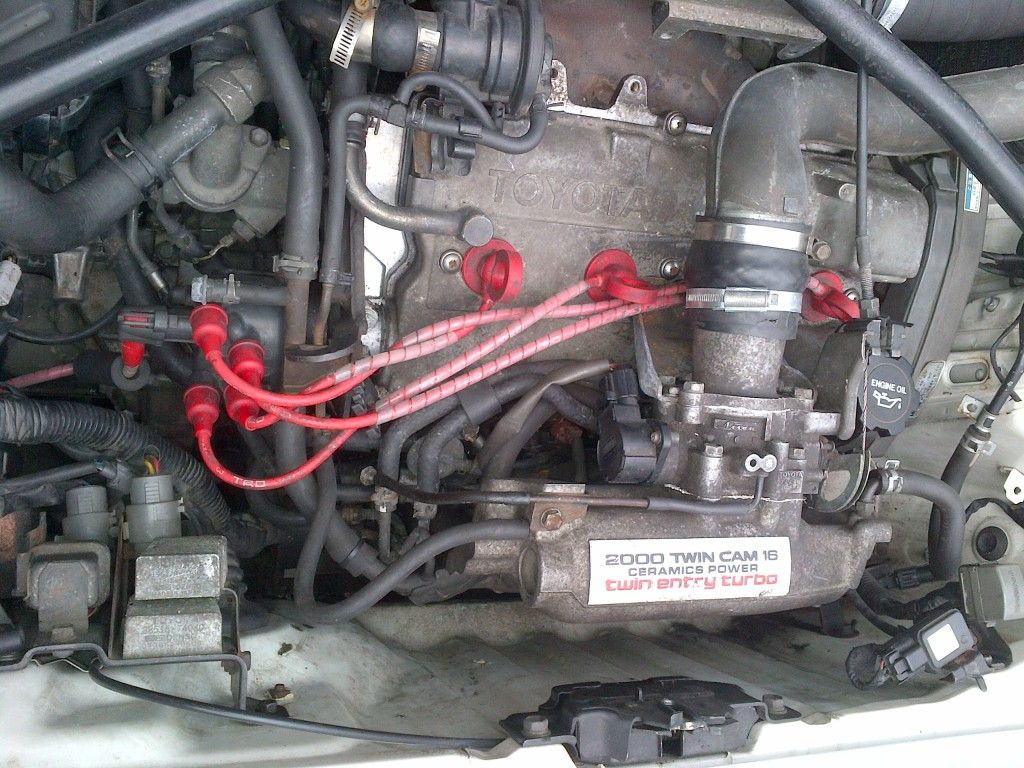

Not sure what you mean about the "rectangle box with a lead connected onto it after my air filter" pm me a pic and ill post the pic .. maybe even answer your question :thumleft:
Welcome to the forum mate :thumleft:
Just reread yes thats the air flow meter mate .. i still ran a hks ssqv with no problems :thumleft:

Like this .

The pic i posted if you look at the top of the throttle body theres 2 vac lines attached .. rev1's only have one .. thats a good way of telling a rev1 from a rev2 engine :thumleft:

2mad wrote:The pic i posted if you look at the top of the throlle body theres 2 vac lines attached .. rev1's only have one .. thats a good way of telling a rev1 from a rev2 engine :thumleft:
^This.
J reg could be either rev1 or rev2. Chassis number is the best way to tell, but the above is a good visual check.

Rev1 engine :thumleft:
