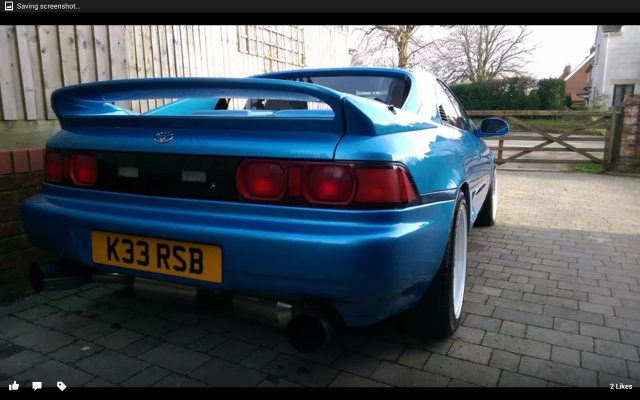

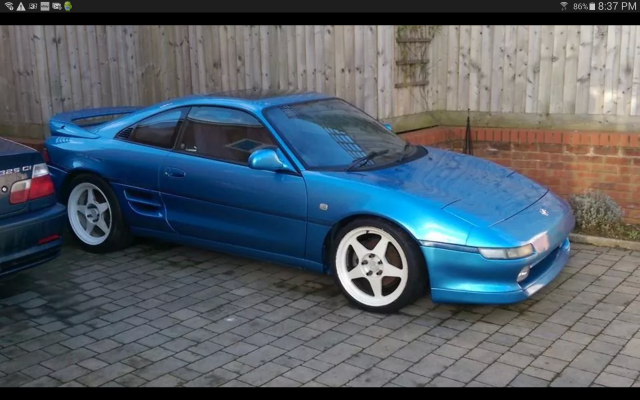

I've gone for 235 45 17's on the rear as I like the chunky tyre look and it affords a little extra comfort. I presume the speedo signal motor is linked to the rear wheels through the gearbox and as such I will have a slight over-read on the clock of about 3mph at 60? Not bothered, just curious.
With the above profile I am considering either a 40 or 45 profile 215 17" tyre up front.
Does anyone have any advice on which is best in terms of forward tilting stance with the 40's or if the 45's cause other issues etc?

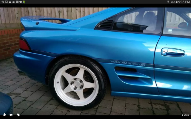

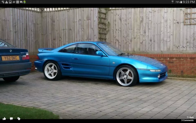

Mark, how does the extra 5 mm side wall on each side of the tyre equal 18 mm or am I missing something?
As far as I can see, with coilovers I can get a great looking stance at the rear whilst maintaining the ride comfort that 16's give on 45 that I'm used to. These are the 45 rears on:
Yes 6% speedo over read but as it under reads by about 5 mph at 60 I'm out by 1 mpg.
We'll see how it goes, not saying I'm right but wanted to try something more purposeful looking than 35 or 40 that can look weak.
Will most probably stick with 40s at the front as there is less weight to dampen with tyre wall and will help the front pitched stance.[/img]

45 looks fine to me on the rear - the front is an old flat 40 profile that I think looks pants but was used for clearance evaluation. ... and ride height is still at maintenance level.
