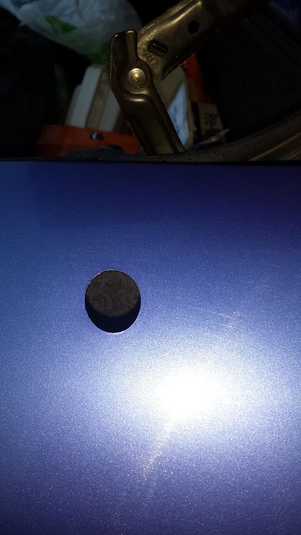

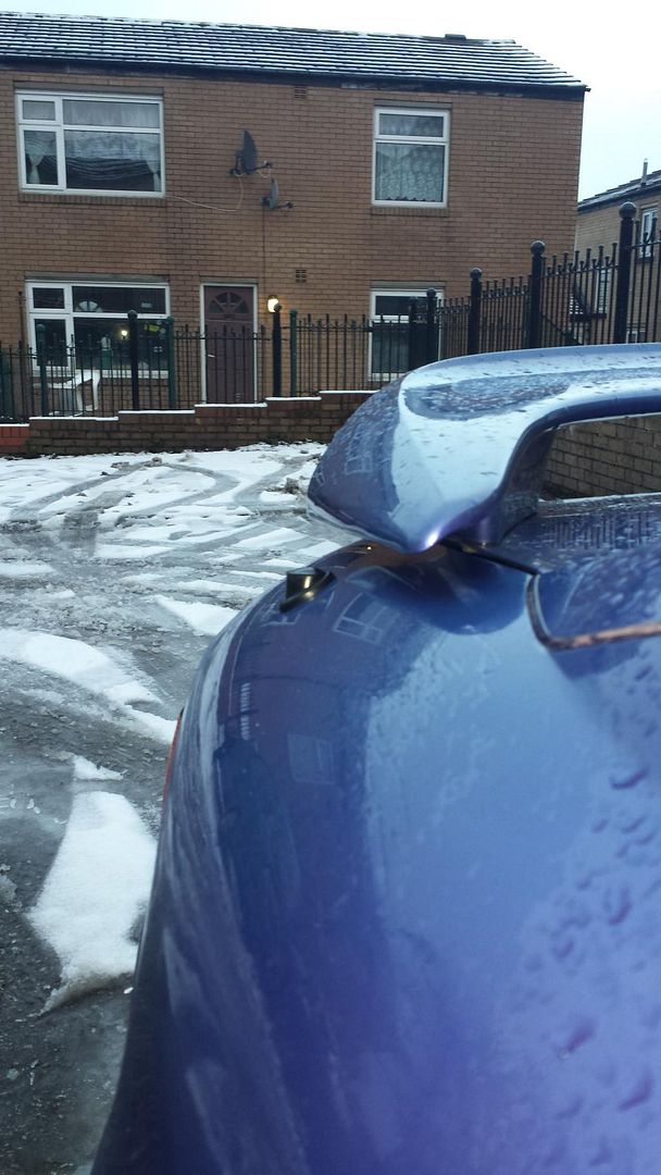

Thought I'd have a go this afternoon.
Pulled the old aerial out, turned out to be a cheap knock-off one. The hole in the wing was around 31mm x 25mm. I had a few blanking grommets (1", 7/8" & 3/4") so tried the 1" directly into the wing. There was a fair bit of vertical play so I opted not to go with that.
Got the original grommet from the aerial unit, and a 3/4" grommet was a tight squeeze, but once in wasn't moving. So that's what I've done. Grommet into aerial grommet, into wing. Theres a thin layer of silicone between all mating surfaces to try keep it all watertight. Looks a lot tidier than before, and less of a hazard.
Anyways, pics.
You can see the old mast in this photo, snapped and won't fully retract. Also very sharp.
Aerial Hole:
Grommet fitted:
jimGTS
Posts: 14024
Location: North Kent
Re: Aerial hole diameter??
Post by jimGTS »
Nice work!
Exactly what I suggested above and looks great.
I may well take my own advise and do the same!
