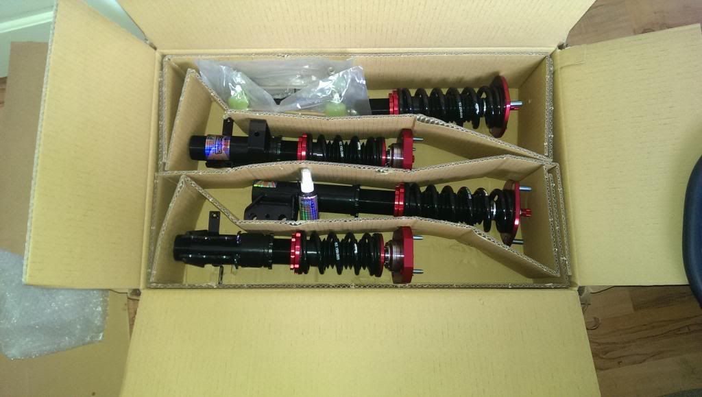

Just got these, 10% discount using IMOC code from miester r
Whiteline anti roll bars come tomorrow....
Who can set them up in the fife area? Any garage with laser alignment??

Ohh those look nice :lol:

the fronts have pillowball adjustment but the rears dont, is it likely ill need camber bolts to fully adjust the rear??

For best adjustment u will need camber bolts (eibah ). But could be good without. I had in my mr2 wrong camber , was needed slight alig , so bought eibah camber bolts and was help.

Front coilovers are fowling the wheels on my 17's and 18's
Miester r want me to try on standard front wheels see what f there's issues with them.
Anyone got standard wheels they use in winter I could pop on see if they fowl?
Nothing goes smoothly with me and this car, I just want to drive the thing now and there's hurdles at every turn!

My standard wheels worked fine with my MeisterRs. What you can try and do is adjust your camber. Not by your topmount but by pulling / pushing against the knuckle whilst your two bolts are loose. That will give you a couple of mm of play, enough to stop the rubbing.

What offsets you running?
As above could try camber alignment bolts or even hubcentric spacers dependant on how much is fowling

I've bought 3mm spacers, I'll be trying those on tomorrow, I didn't really want to touch the camber, was gonna leave it to someone with the proper setting up gear
The wheels are 8j et 35 and the only height I can get is at the lowest setting so the nut sits kinda inside the wheel, the 17s didn't work at all unsure of the offset on those though, I'll be trying the 17s with the spacers first, as I need rear tyres on the rears of the 18s (more money!)
