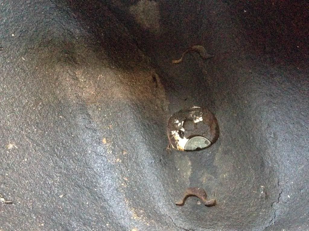

So I was taking out the boxes behind the drivers seat and found a hole in my floor. :(
Not really sure what the best way to fix it will be but I guess it's cut and weld. Since I can't weld I fear this might get expensive.

Sorry. Forgot about that. Looks much worse in person but not a huge hole. I do have some of that epoxy putty with the steel in it?

To be honest I would just rub it back, fibreglass it and spray with some good anti-rust treatment.

Lol, is that it? i was expecting to see half the floor missing, just clean it up and rust proof it then paint, not structural there anyway.
have you checked inside the ends of the boot? usually rusts well in there

Yeah maybe I panicked a little bit but it does look quite a bit worse in person. Will look at cleaning it up etc. Not looked in the boot quite scared to now. :(

Is that behind the seats? If so, it's not a hole. It's a weird circular part where the sound deadening doesn't cover. There's one behind each seat.

It is behind the seats. Definetly rot though as I can see light through it and put my finger through.

Ahhh. Bad times. Best thing to do would be to take out the sound deadening and look at the full extent of corrosion.

Get underneath the car with a wire brush/ angle grinder and clean it all up, see how bad the damage really is, I would inspect the rest of the under side, and rear sills at the same time- the earlier you spot this sort of damage the more likely you can get away with a small amount of preventative maintenance instead of having to replace whole sills and arches, etc.
Once you can see the damage- if it's just a small hole in the floor pan, then making a steel patch and seam welding it in is not a big job, I'd expect a local welder to knock a simple patch up and weld it in very quickly for minimal cost. Prime, paint and underseal and the jobs a good 'un :thumleft:

There a small hole behind each seat they have rubber bungs in originally, it looks like one of them to me. My car is completely stripped out other than the seats & I pushed the bungs out so they act like drainage holes for any water that was sloshing about on the floor :thumleft:

I'll have to get a better pic maybe tomorrow. It's near the bungs but lots of pin holes and a fair bit of rust around it. :(
