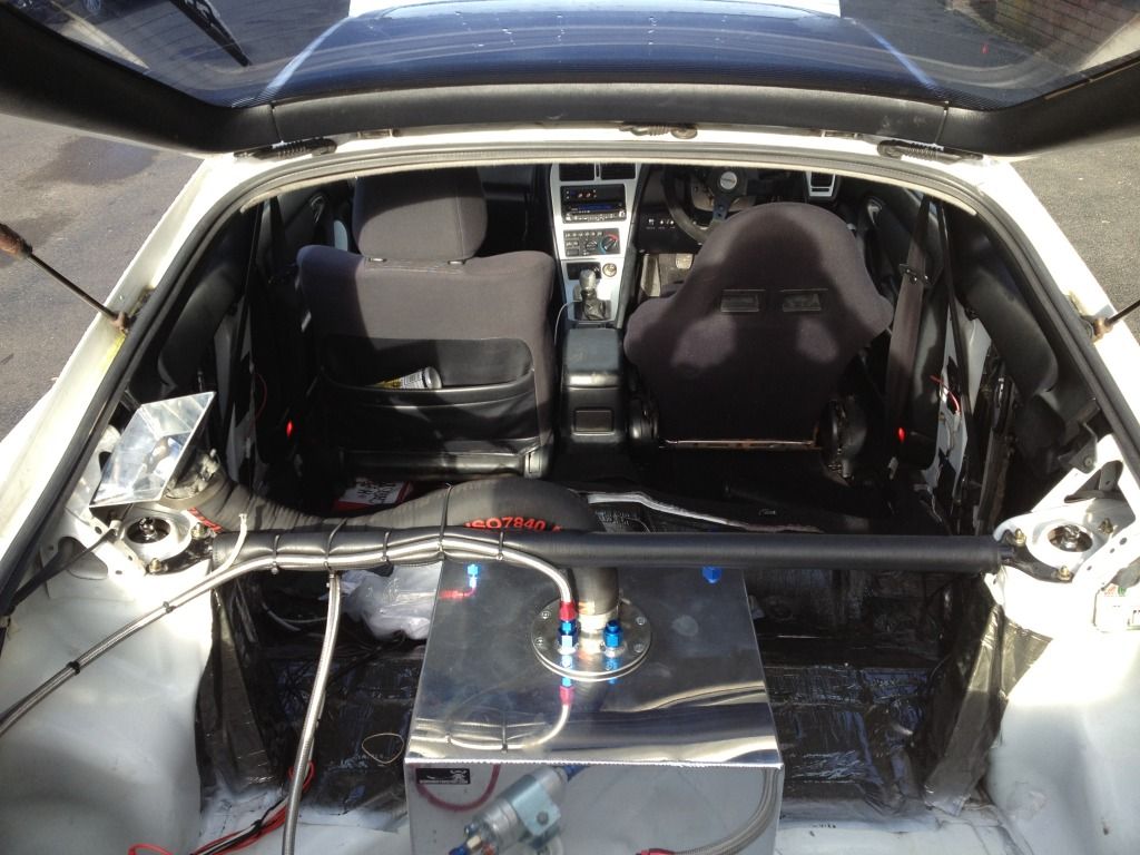

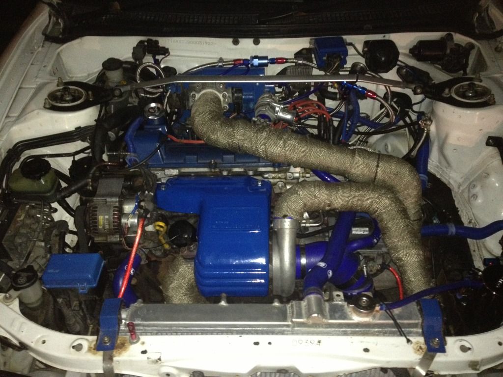

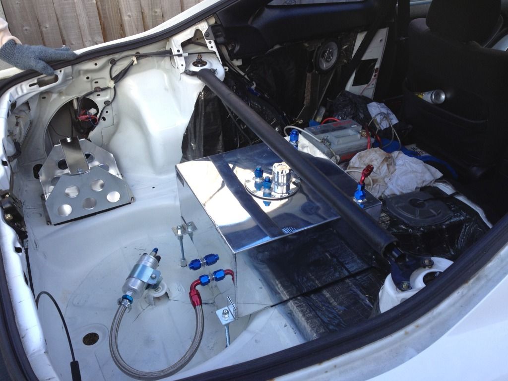

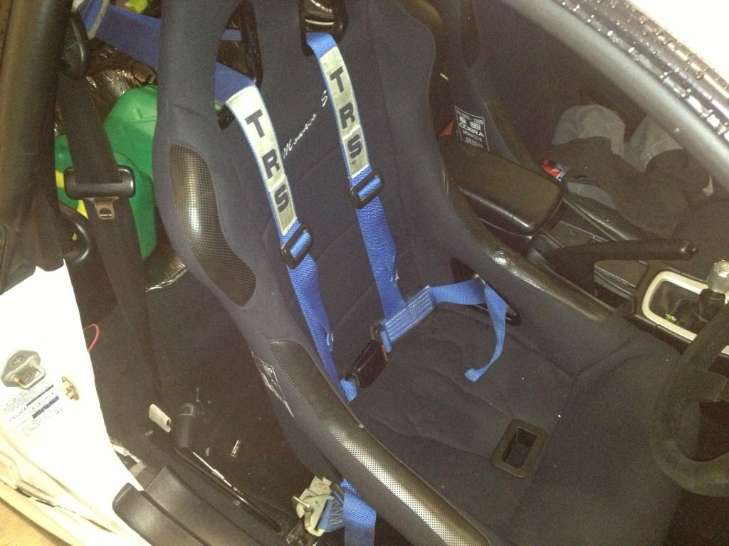

well i have been busy recently trying to turn the car into a track car. I have installed a rev 2 3sgte into a celica st202, i have installed a rev 3 head gasket, serviced the engine, 60mm alloy radiator, massive FMIC, AEM FIC piggyback ecu mapped by Jdmodified, 40 litre fuel cell, 305lph fuel pump, 540cc rev 3 injectors, bored out 8mm fuel rail, 6an braided fuel lines throughout, d1 spec adjustable FPR, STAGE 2 hybrid turbo, 2.5" exhaust system, CAI, cobra monaco pro bucket seats, trs harnesses, helix stage 3 clutch, just want more power without opening up the block.
