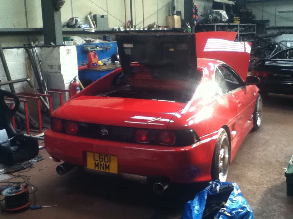

I merrily drove the car for about a year, commuting every day to work (12 miles of deserted country B-roads, every single day...!), did some minor tweaks and maintenance here and there but mostly just drove. It didn't let me down and put up with a lot of abuse, including one incident with a badger's corpse (the downside of deserted B-roads! Car was lower than I thought).
Until one fateful day in about September 2012. The occasional overheat problem finally caught up with me, and rolling into work one day I noticed the temp gauge rocketing upward and steam come billowing out. I limped the car to Rogue Motorsport, an MR2 specialist not far away, who condemned the engine with massive head gasket failure and likely some form of internal damage besides. Not even worth taking it all apart and trying to repair, the problems could be so widespread. It was all over :(
I explored engine swap options with Matt at Rogue who walked me through what we could do. Swap in a new 3SGE, go for more power and swap in a 3SGTE (standard turbocharged MR2 engine) or go big and fit a V6, something I've wanted to do since I first heard about that swap several years ago. Unfortunately they were all way out of budget and I just couldn't do anything for the time being. The car came home and took up residence on the driveway - where until very recently my wife's dead MR2 had resided. Just traded one dead MR2 for another - oh dear...
I needed a runabout to get to work, so did a quick Autotrader search for sub-£500 cars within 20 miles. Ratty Clios, knackered rusty Peugeots, maybe a tired Honda or two, oh and what's this? A tatty MR2? Well, it would be rude not to! Even the worst MR2 would be better than a FWD hatchback. The deal was struck and my runabout while my MR2 was off the road was to be... another MR2. Glutton for punishment.

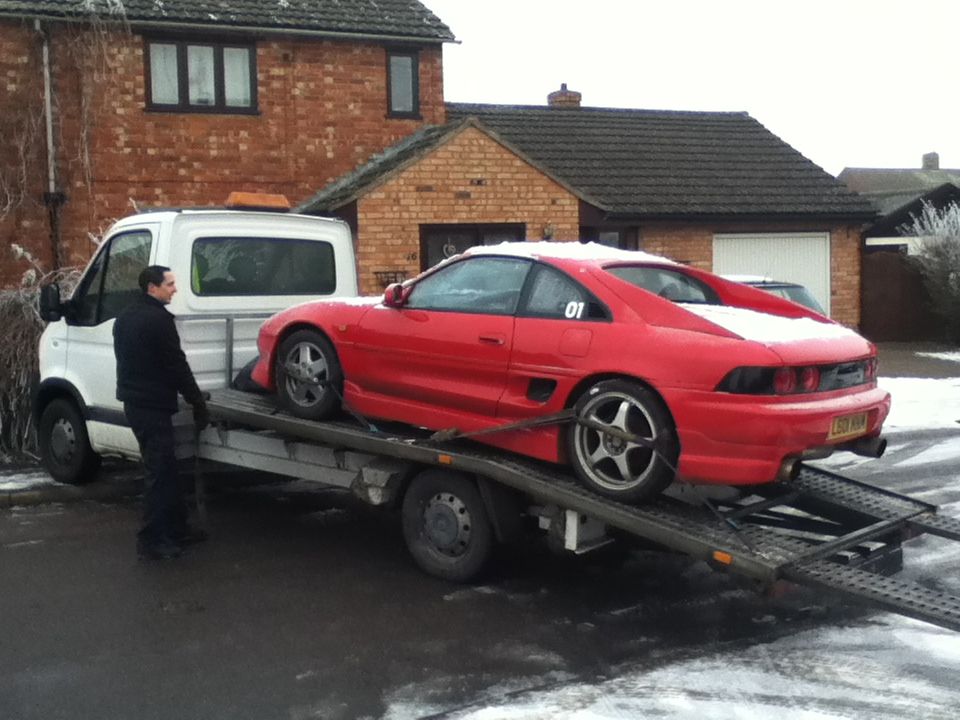

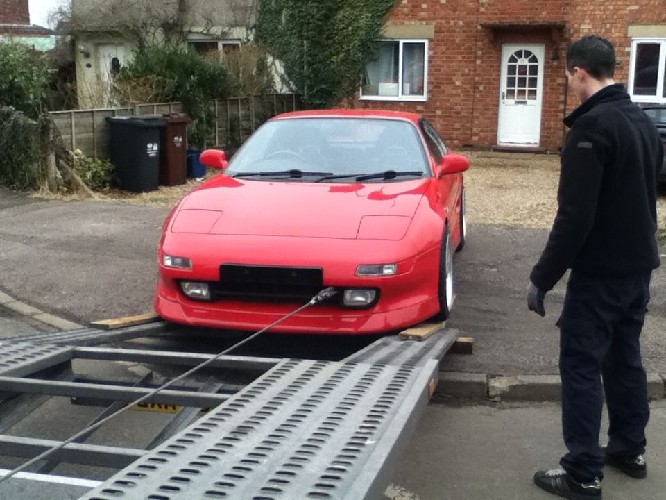

Off she goes:

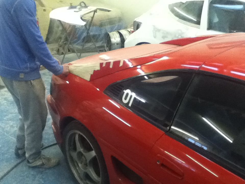

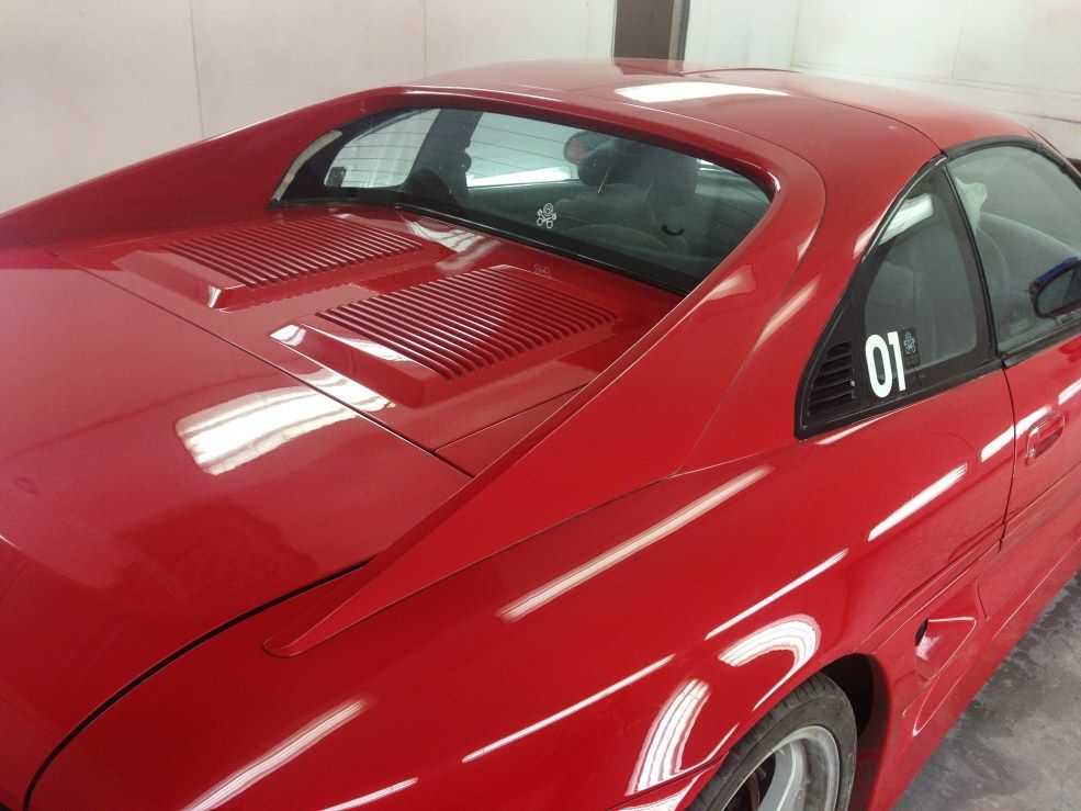

In it rolled to Xquisite near Guildford in Jan 2013 with orders to revise the buttresses to remove the hump (without compromising the side profile), fit and paint a new rear bumper and repair the Badger Damage on the front splitter. I wanted to build something a bit sleekerand more exotic looking, less tuner-ish. Here's how they got on:

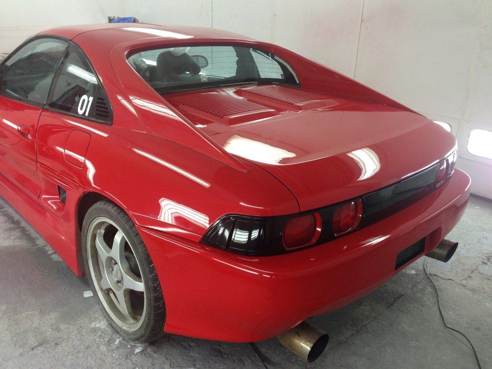

You can see what they did here. Sliced the top off to flatten it in the side profile, and moved the rearmost tip outboard, by only a few cm. A tiny change, but it made all the difference.
No more hump!
They did a really nice job on the finishing of it. The corner radii are really tight and the whole thing generally looks lovely.
Homeward bound.

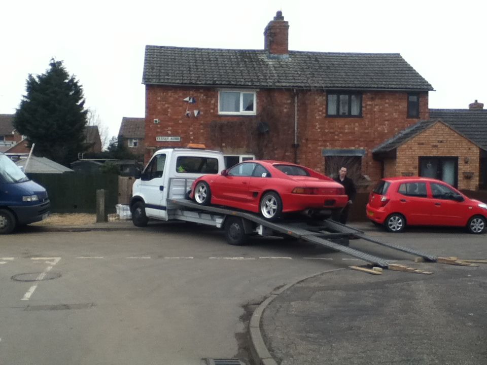

Soon, destiny was within my reach - the money was in place and the car booked in to meet its destiny at Rogue - a donor car was sourced and off we go on the trailer one last time:
Clearly in the right place (check the background):

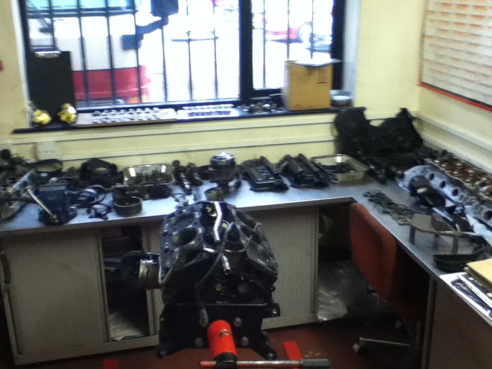

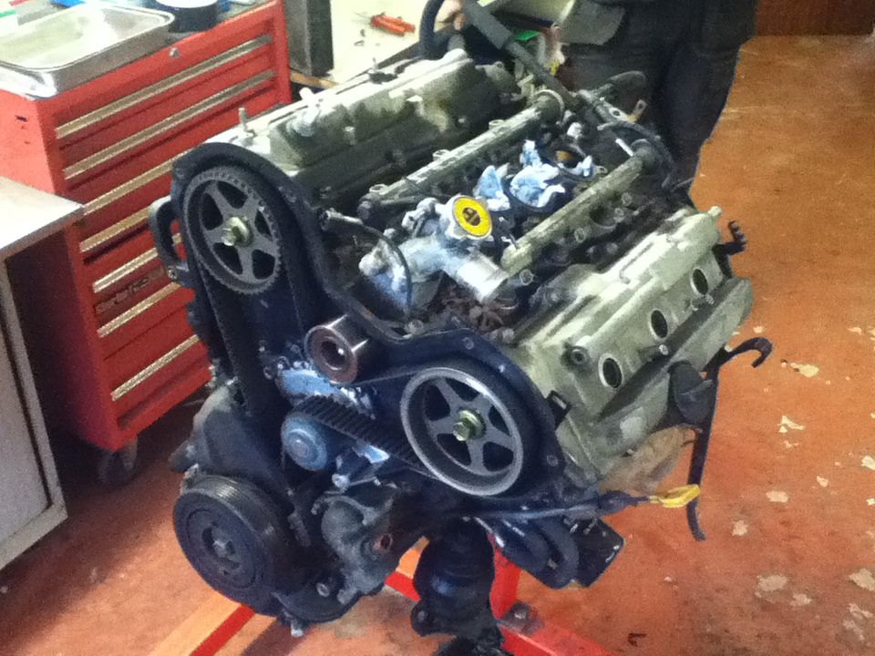

Goodbye, knackered 3SGE, you did well:
The new mill awaiting rebuild:
One day, all of this will be yours:
The Rogue conversion package is great and includes basically a full strip and rebuild including replacing things like big end bearings. The engine is basically brand spanking new now.

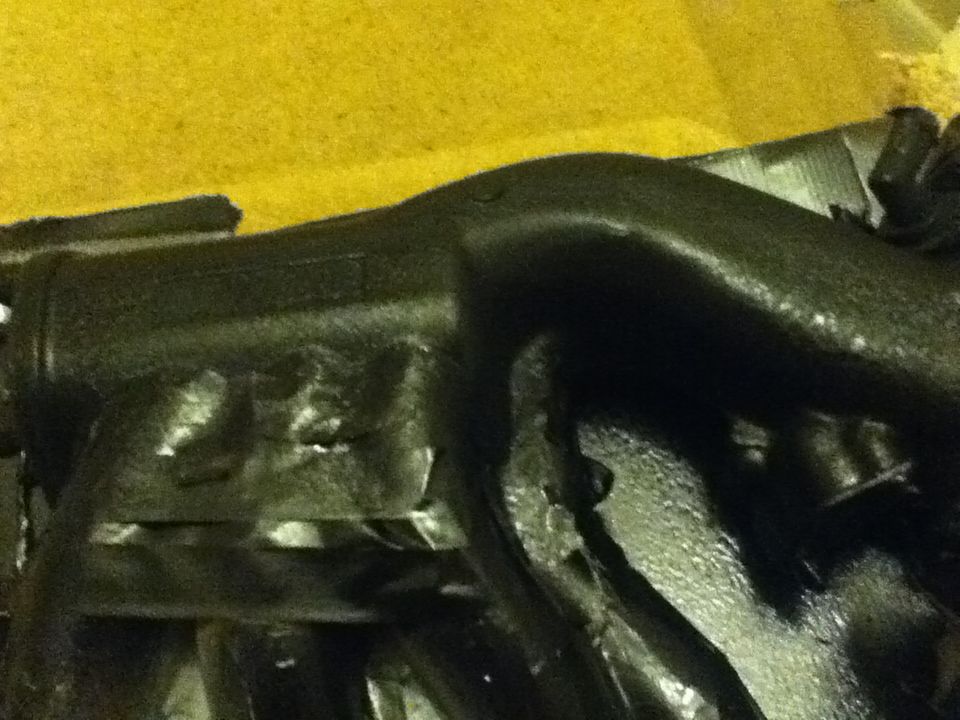

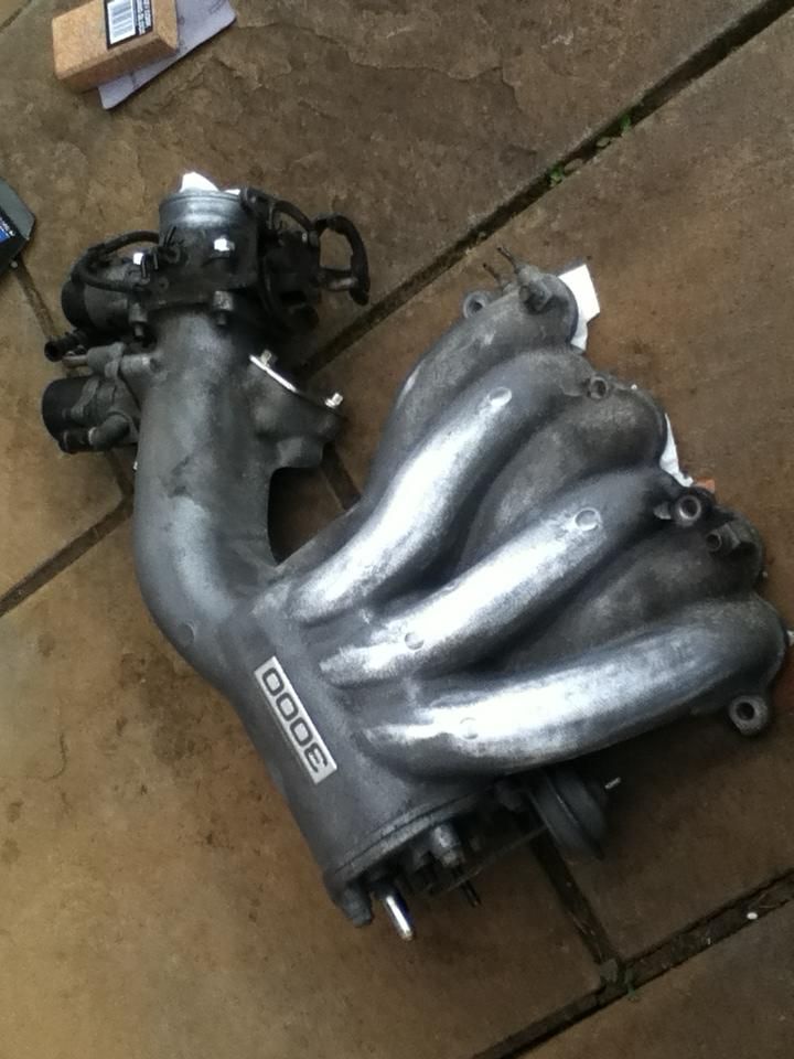

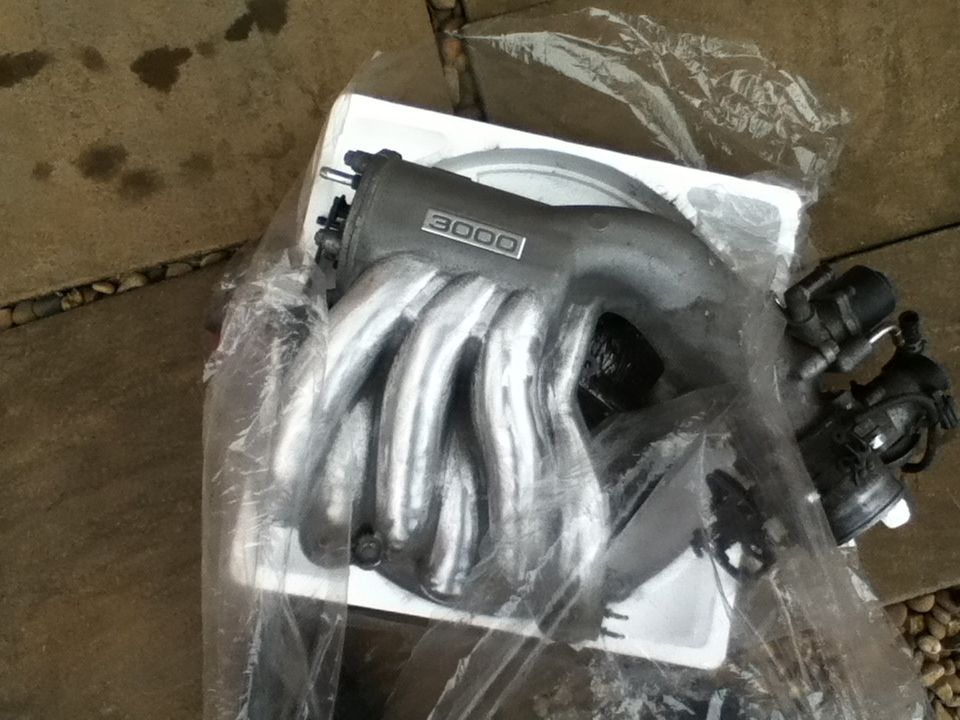

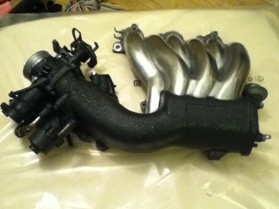

And now comes my final customised contribution to the build. The standard V6 intake manifold is a bit pants looking, at best most people seem to sand them down and spray them a ghastly blue all over or something. I wanted, once again, to make something more special feeling.
How it would look in an MR2 completely standard:
I wanted to highlight those sexy looking interflowing pipes, and seperate them from the big canister bit which makes it look like one big solid lump.
I went at it with some sandpaper (and hours, and hours and hours of sanding) and the rest is history.
Some wrinkle black paint:
And then unmasked and with a spot of polish reveals the true loveliness of the finish that I presumably paid for by bringing forward the onset of arthritis:

The rear buttress extension is really sexy dude, and you're right to have fixed the hump.
Very impressed!
Please do keep checking in :thumleft:
Can't stop looking at it :lol: I want your rear buttress please.

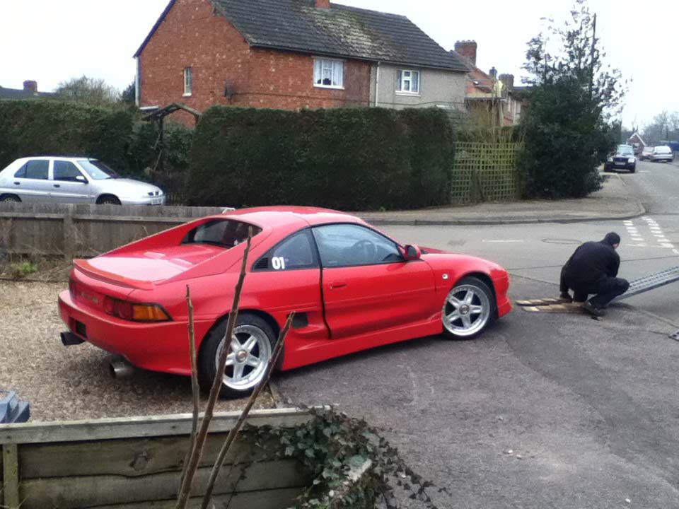

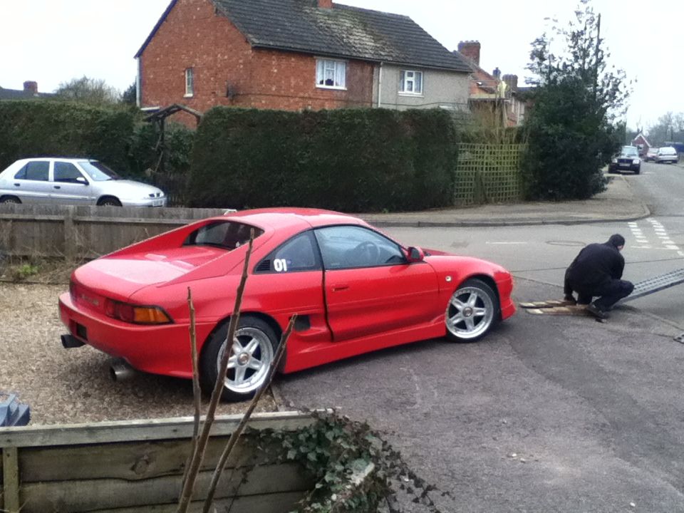

Not a great deal to see here right now, but...
Looking a bit sorry for herself again - had some issues with my spacers & needed to sit on some wheels that Rogue had lying around for a few days. But still...
What you see before you is a poor photo of Patrick engrossed in wiring on Thursday... and what that means is that the engine is fully installed mechanically! He said that he would have it running by the end of the day which should hopefully leave Tuesday (day after tomorrow) to have a cold start test and a road test, and then all being well have the car back to me!
And with not a moment to spare, too, because I'm out all day Thursday and then need the car at 10am on Friday morning to embark on a 675 mile lap of Wales :D

Alignment and road tests tomorrow, then dropped off at my house in the evening - when I'm not even there! - the first I see of it will be Friday morning shortly before embarking on an 8 hour drive to Aberystwyth, via Ffestiniog... \:D/
Fiddled the back end a little more, reverted back to my previous rear light setup with the addition of a little Toyota badge in the centre to try and give a focal point when looking at the rear.
