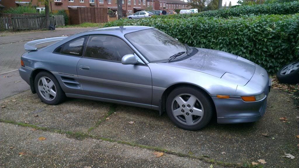

Hi, I picked up a 96 Rev 3 Turbo just over a week ago and I love it. I've had 2 S13s and an R33 previously and I much prefer the MR2.
It's a tin top with a mongoose exhaust, mandrel bent downpipe, apexi filter, HKS ssqv BOV, greddy boost controller at 1.1 bar, ARC intercooler, turbo timer and man in dandism mats :-)
It's in pretty good shape, clean engine bay and sills, no real rust to worry about, lovely interior and my favourite colour - steel mist grey.
I took it to Pacific works the other day for a health check, will be taking it back there soon for a cambelt and a few other minor bits.
I don't have many pics as yet and I can't post URLs yet but today I tried on my Enkei RP01 wheels and I think they look pretty good. I need some smaller tyres and some wheel nuts. Toyota, your nuts are strange, lol.
My plans are to get the essential cambelt and service work done asap, fit the Enkeis and just enjoy it. It will inevitably get faster at some point in the future but I'm happy with the power as it is at the moment.
The only problem with the car is the paint on the light covers, wings and doors. It looks like it has reacted to some overspray and someone's attempts to polish it out has made it worse. I will address this in the future but it's not a major problem for me.
I have noticed that the dipstick pops out every time I drive it. I'd be interested to know peoples thought on this.

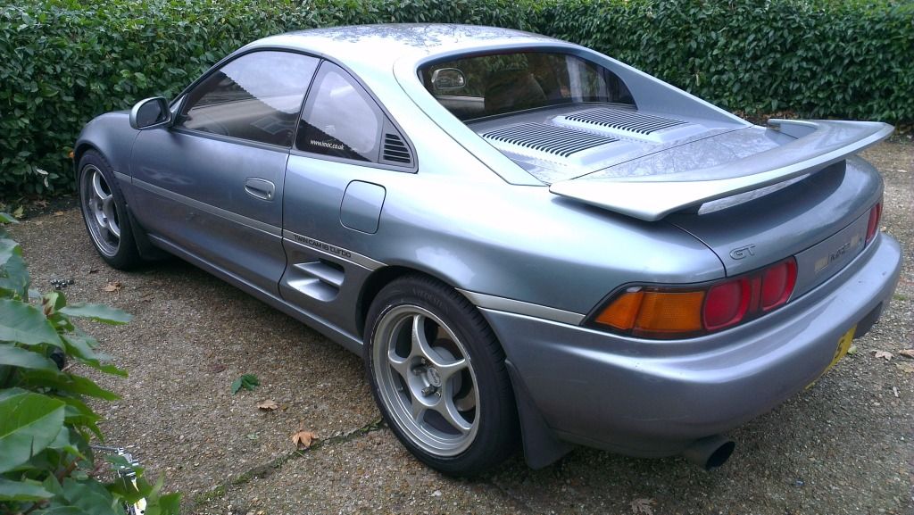

And with the Enkeis:

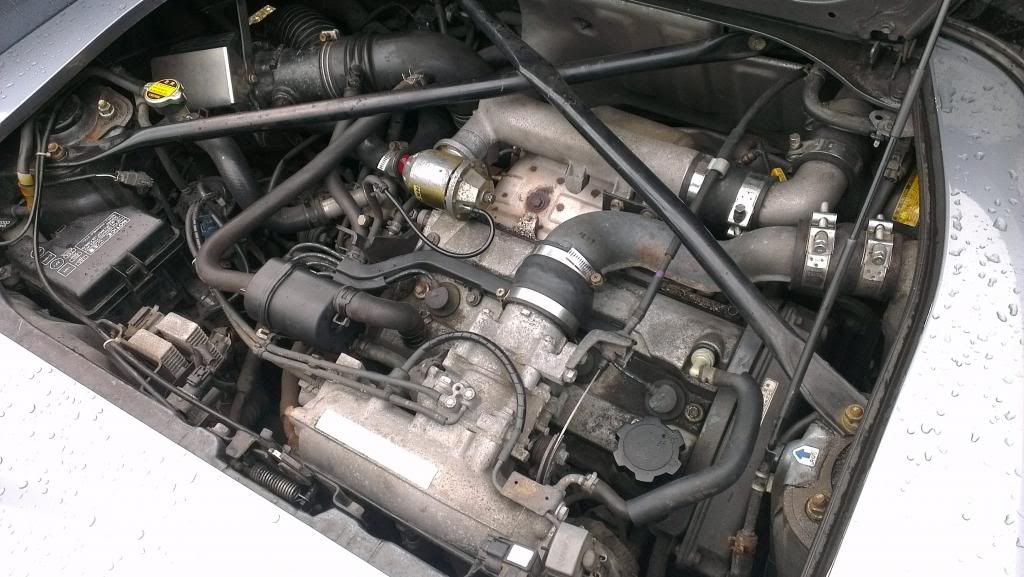

My Bay. It will get shinier.

looking good man, those enkeis are well rare :thumleft: :thumleft:
although, same as mine :lol: :lol:

Those Enkei's look great! What are the wheel and tire sizes?

Zeiretto wrote:Those Enkei's look great! What are the wheel and tire sizes?
Thanks!
Rear 17x9 et 38 245/45
Front 17x8 et 35 225/45 EDIT: ACTUALLY ET 38
The fronts don't fit with that tyre - it fouls on the spring seat. I've been advised on 215/40/17. If you could still get 225/40/17s I would go for that.

Nice car mate them 17" enkies are gorgeous and seem to be popping up a lot lately I've been trying to find a set for ages :(
And I have 225/40/17"s Avon tyres on mine :) so are still available mate :)

I havent been able to find that size for years. Blackcircles, etyres, mytyres and camskill don't do them anyway.
I love the wheels, I think they look good on anything but especialy suit the MR2 :)

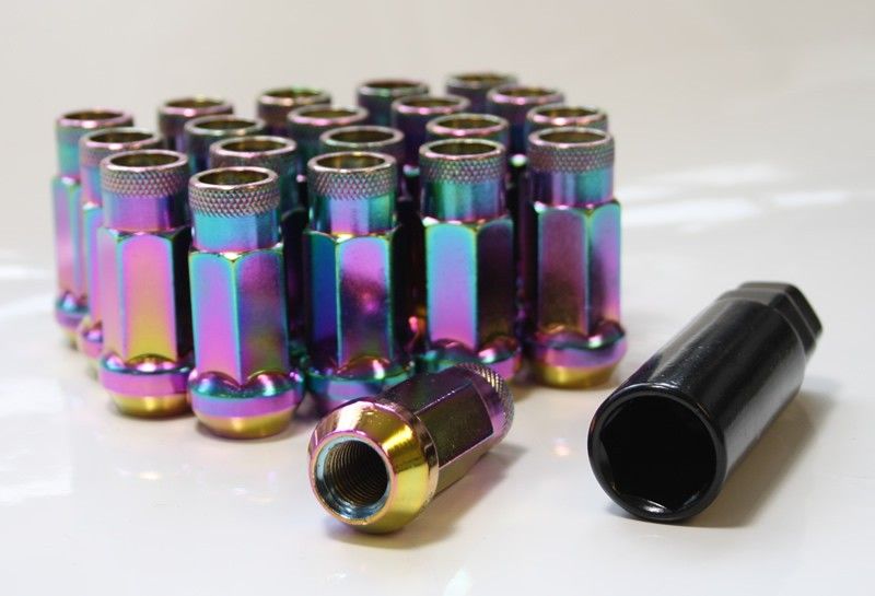

I'm looking at these nuts:
I'm not sure if they will look a bit daft or be subtle enough to just look cool on closer inspection. It will be 2 weeks or so before I get the new tyres anyway so I might change my mind.

Are they Muteki lugnuts? I had those on my Celica, they're awesome!

They look like the ones from driftworks. I've just ordered a set but in black, the neo chrome ones was too bling for me. :o

Indeed they are. I might get the more subtle black ones, it will depend on my mood come payday, lol.
