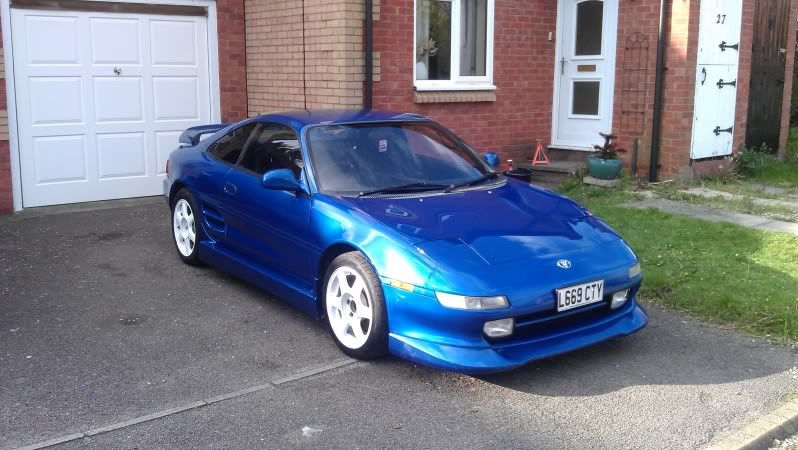

couple of pics of the 2,
the wheels are in pretty good condition but I'm think of doing them white any houghts ?
my lads 6v quad is faster at the moment :) anyone know what the skirts are ?

budd wrote:
the wheels are in pretty good condition but I'm think of doing them white any thoughts ?
Erm
White wheels you say... the answer is YES!!!
