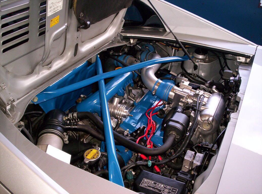

Driftlimits Performance
IMOC Affiliated Company
Posts: 4928
Location: 01442 601301
Re: Apexi AVCR - Fitting advice
Julian, here's a pic of Jezs' car. But only the engine, I can't find my other pics.
There is an avcr in there, solenoid and pressure sensor. find it if you can! lol
