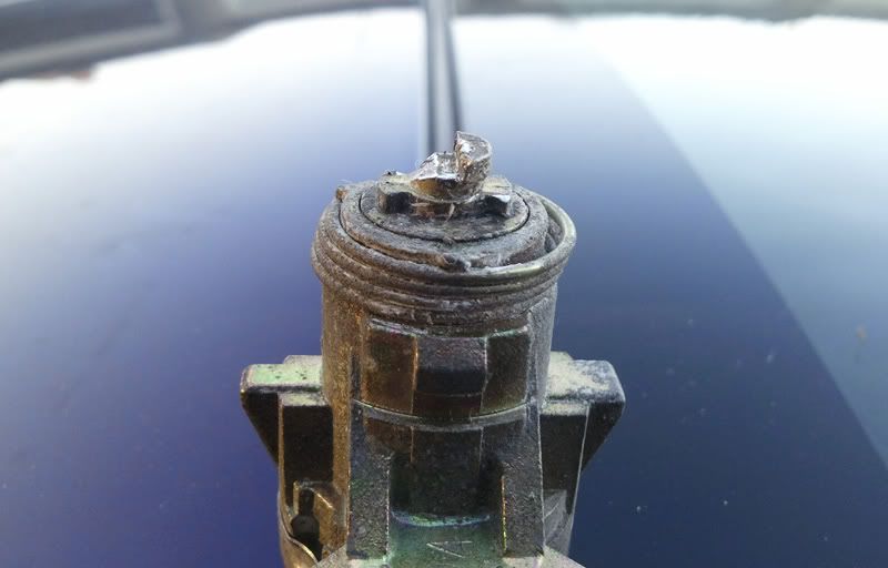

The instructions above are bang on and it's actually not too bad (albeit a little fiddly. The one thing that went wrong but sort of worked out out was removing the barrel from the pulley arm. On mine the bolt snapped:
I think (touch wood) it's okay though as the 'keyed' metal below the screwhead fits into the metal bracket and then the central locking wiring clamps on top.

Please take care that the plastic cap over the barrel (exactly on top of the screw in the pic) has two clip, one on each side.
I've broken one and now the power lock is not commanding the passenger door.
Racer7 wrote:
PS:
Mickey's ears are just below the margin of the pic.
The magic numbers are on the other face of the barrel
