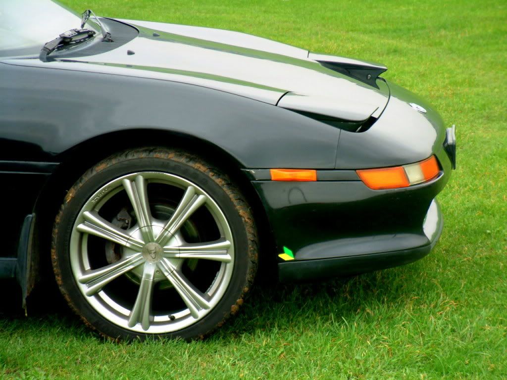

they been sat in the garage for ages but then it came to me in a dream.
.why not put them on the mr2
im not a big fan of the wheels iv got on my car at the moment.
17" wolf race 7 spoke things
and i shall swap for
[/img]

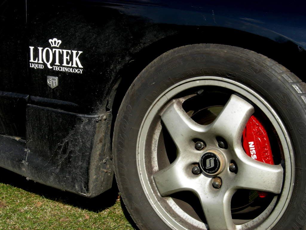

Re: Finding Wheels From Other Makes for your Two
I'm running R32 wheels on my MR2, 8" wide R32 GTR wheels on the back and 6.5" wide R32 GTS wheels on the front.
Offsets are just about perfect
- only thing I had to do was get some custom spigot rings fitted to ensure they were centred on the hubs properly.
Tyres are 225/45R16 rear and 205/45R16 front.
The GTR wheels are forged so very light, lighter than the cast fronts ironically.
Annoyingly the GTS wheels are a lighter shade of grey and than the GTR ones so I got them refurbed to make them match.
