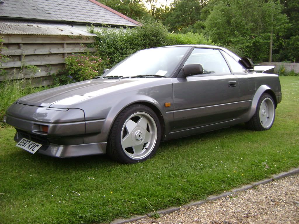

Re: Will these wheels fit on my rev 5 mk2???????????? DEEP DISH!
Post by Charged »
have these wheels on my Mk1.5:
