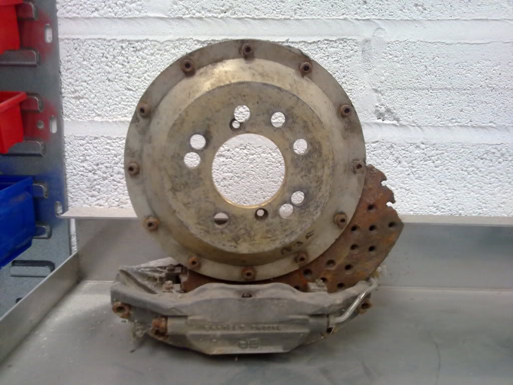

Hi guys and girls been on here for a while thought i would try my luck at putting a few photos up not too sure how it will work so bear with me thanks will comments welcome

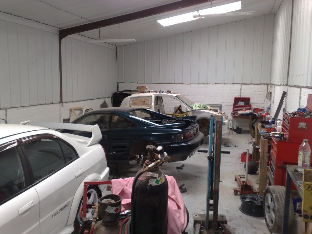

hi will, welcome to imoc :D
looks like you have a couple or real beasts there lurking in your den

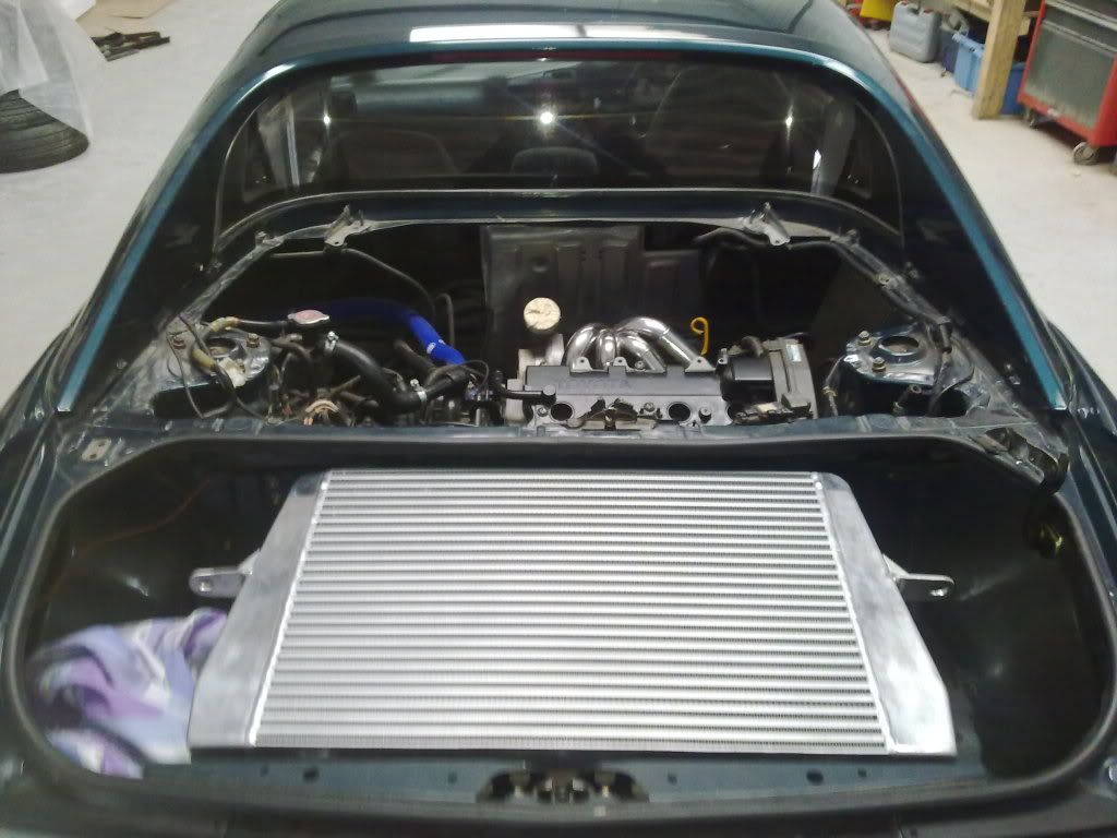

btw, i think your intercooler needs to be a little bigger :oldtongue:

i thought that too, is that just the stock one mounted in the boot??? :lol:
nice motors :thumleft: :thumleft:

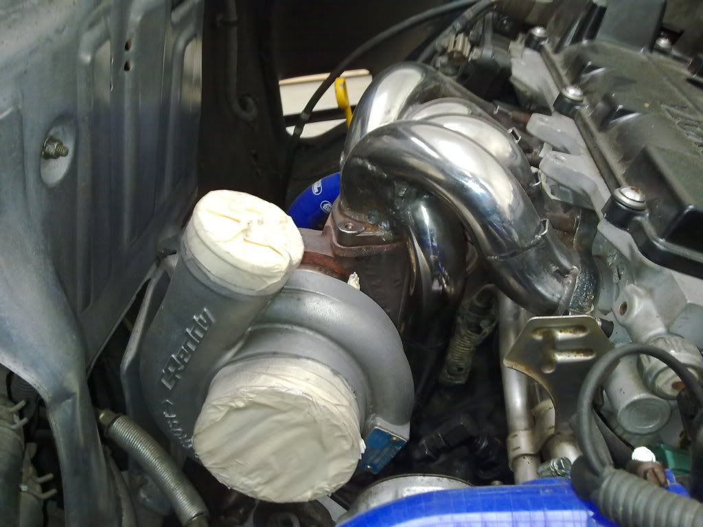

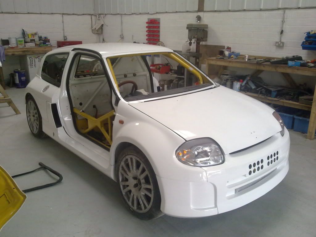

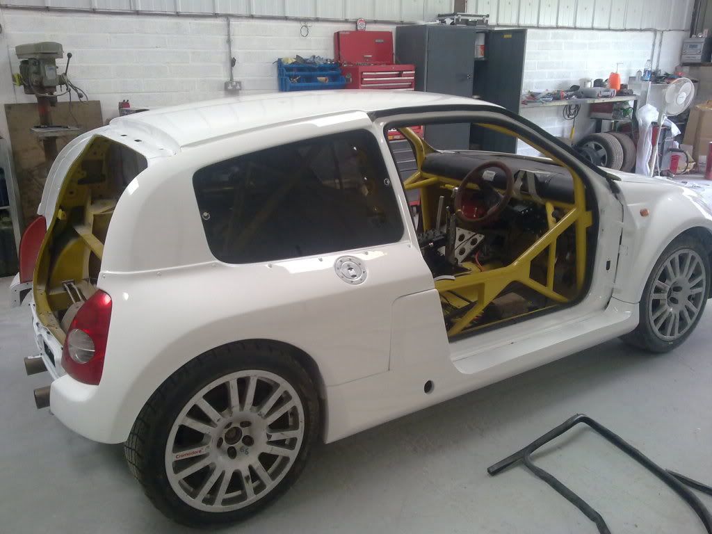

hi the intercooler is just a cosworth rs500 one laid down just been playing with how im going to mount it and box it all in,the spec of the mr2 is not the biggest on here by far but hopefully want to see over 400bhp,its got, je pistons,eagle rods,acl race bearings,arp bolts,new oil pump,water pump,cosmetic headgasket,standard head but fully reconed,greddy t-67 turbo,greddy type-r wastegate,screamer pipe,1000cc injectors and topfeed rail,apex power fc,blitz nur-spec,probaly someother bits and bobs throw in as well,the clio is a renault built cup car,they used to run a championship between the f1 races, its 3litre v6 about 300 bhp ,6 speed flat shift box,massive 4 pots all round its a proper car,the brake disc is from a friends crashed metro 6r4,glad u like
