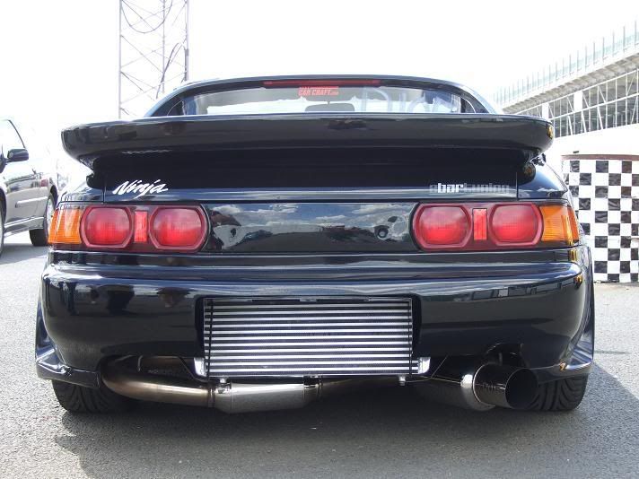

Some shots taken at Santa Pod on Sunday at Street Nationals. Had a few problems on the day, I blew the turbo to manifold gasket which may have caused the fuel cut problems, or the fact that it was a very hot day and my oil temps were soaring. Time for an oil cooler methinks, what sort of oil temps should I be seeing after giving it some welly?

lovely :thumleft:
Rogues old car if I'm not mistaken, a LONG time ago though :D
what was you best 1/4?

looks awesome, that rear end is :thumleft:

that car is yummm mate! :thumleft: good pics too!

Lurvely looking car mate, lovin the rear view :mrgreen:

Cheers guys! I'm really pleased with the looks, the IC was designed with performance, looks AND practicality in mind I still have most of the boot free! The boot floor has been re-structured to accomodate a scoop.

Having seen Paul's car during the build stage, I can confirm that the fabrication work on the AMIC is first rate. :thumleft: In no way whatsoever does the IC look "stuck on"
I have to agree as well, this is one of the best looking mk2s around. Definitely the meanest looking :twisted: :D
