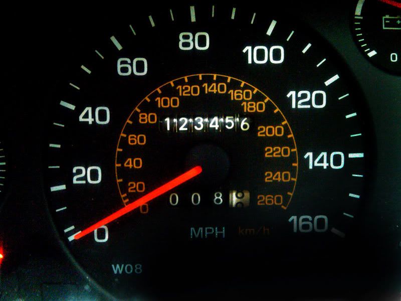

Bit of a mile stone today, 123456 of them infact!

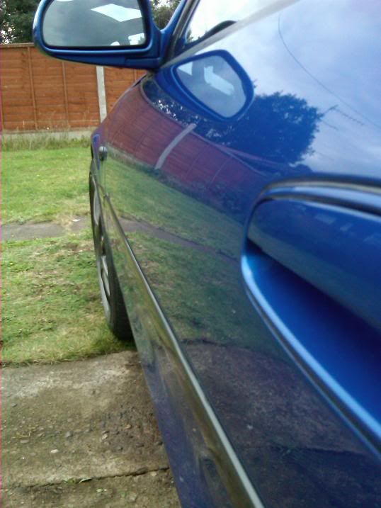

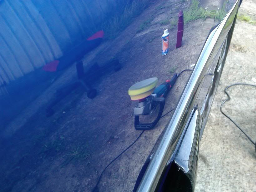

I've been busy wet sanding the car to get it 100% orange peel free:D
It was resprayed about two months ago, and while the bodyshop did a good job of throwing the paint at the car, they didn't do a fantastic job of removing the orange peel. It wasn't bad, but wouldn't have looked out of place on a new Ford or BMW.
I've only had time to get the near side panels done so far but I'm very happy with the result :D
Process was:
Wash,
Clay,
Wet sand with 2000 unigrit
Polish with Menzerna Power Finish (PO203S) on a Menzerna Polishing Pad
Then refine with Menzerna Final Finish (PO 106 FA) on a Menzerna Finishing Pad
And lastly protect with Dodo Juice Purple Haze
The reflection speaks for itself:

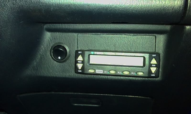

Got my fog light sorted today after doing the quad 'stop/tail' mod a few months ago, and losing the fog light switch when I fitted the TEIN EDFC.
I decided to put a red bulb into the off side reversing light and wire that as the fog light :thumleft:
And for the switch I removed the knob for adjusting the brightness of the instrument cluster and fitting a round rocker switch. The tell tale light is on the instrument cluster so will be fine for the MOT :thumleft:
