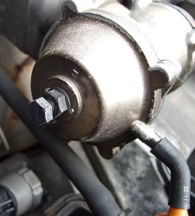

Leeroy wrote:Oh and re. your DV flutter, if you want less flutter then just adjust the screw in the back (depending which version of SSQV you have).
This screw anti-clockwise?

Not sure which way mate, possibly CW? Just do it half a turn either way and see if it changes. Unless someone else knows...

just a guess but I would unscrew it (Anti-Clockwise usually). This should allow the valve to open easier under lower boost (tighter it is the harder it is for the valve to open) well thats what happens with my XS dv anyway ;).
Then again thats if that screw is to adjust it, my XS uses Washers (add washers to tighten remove to loosen).. I dont want the blame if your DV comes apart and the spring / piston flys out LOL :mrgreen:

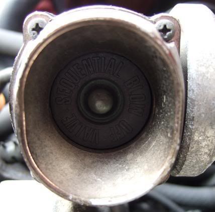

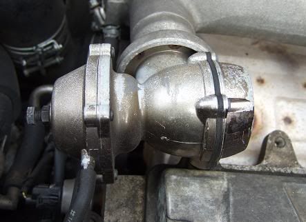

I think it's the old SSQV and it doesn't look like you can change the inserts, actually I don;t think it has an insert. Here's some more pics young man.

ahh thanks for the pics old man Image
will think about it, was mainly wanting the new one that could have the inserts changed and the recirc adaptor fitted
