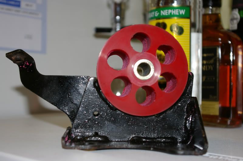

I know this is an old post but I thought I would share my experiences of Speed-source engine mounts on my MK2. I fitted both front and rear mounts but found the @ idle vibration excessive, so I have modified the front mount as in the picture below, which has removed virtually all the vibration. 500 miles on and it's still in one piece.

I did mine not long after the post above.
Following advice from Tim & Chris, I drilled a few holes in each to allow for some flexibility as the felt wey too tight without the holes.
~ 1year on:
You can feel engine vibration slightly more. Engine note also sounds more "raw" (in a nice way 8) ). The engine also feels a little more responsive (but this could just be in my head :mrgreen: )
The engine is still going strong after ~ 3000 track miles too. Best mod for the money so far :thumleft:

Post by System-G »
I only did the torque mounts (front & rear).
The original rubber was fairly shot. I drilled additional holes through the original rubber before pouring the polythane into the mount. This was to ensure I got sufficient polythane on both sides of the mount and to bond securely to the existing rubber. You need to lay the mount on it side and seal the underside so it doesn't leak all over the place.
Once the polythane had cured, I drilled additional holes right through to allow some flex in the centre spigot.
I have some pics somewhere, but will look/upload them later tonight when I find them :thumleft:
Ben
Posts: 3074
Location: Oxford(ish)
Re: Poly Engine Mounts
Post by Ben »
Brilliant, thanks G :thumleft:
2001 BMW M5 (Bahnstormer) | 2004 RX8 231 (the Racecat) | 2001 Volvo V70 (Swedish eBay barge)
Previous:
1989 MR2 Mk1b T-bar | 1988 MR2 SC Super Edition
System-G
Posts: 4554
Location: Leicestershire
Post by System-G »
Right-o. Just a quick "How-To"
1] Clean up the engine mount thoroughly making sure there no oily deposits anywhere and no loose grit or grime.
2] Drill out some holes to allow the ploythane to filter through to the other side. You'll see what I mean later on.
3] Seal up the one side of the mount. I used gaffer tape.
4] Balance the mount/s so they are level (ish)
5] Remove polythane from packaging and mix as directed.
6] Pour polythane mix into mounts. You'll see here the importance of drilling through the original mounts. Don't worry when the polythane cures, it's pretty solid and sticks to virtually anything.
Careful of spillage :oops:
7] Drill holes in original mount were too small so had to fill from reverse side once cured. This also cost another pack of polythane from RS Components ](*,)
8] Follow the curing proceedure in the instructions. As I used tape to seal the underside of the mount, I just left it to cure overnight. But IIRC, the instructions say to bake the polythane.
Once cured remove the seal & packing
9] Drill holes to allow the centre spigot to move a little. My holes are off centre andprobably not big enough, ho hum :eye:
10] Clean up any over-spill. I had to cut it away with a stanley knife.
11] Refit to engine.
1 year on and still going strong :thumleft:

Right, a quick update. I couldn't for the life of me work out how to order the polyurethane from RS, it kept asking me which company I was ordering for :-s
So, i bought a tube of Sikaflex 255 and used that in pretty much the same way. I drilled four holes in the front mount and filled the rear mount, and having just driven the car home I'm very pleased with the results. Engine flap has stopped, and whilst engine vibration has increased along with noise it is by no means an unreasonable amount. Hopefully they'll last a while yet :D
