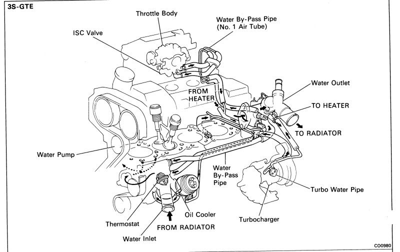

Once it had fuel it started right up ! One main issue is a coolant leak with the coolant running down the back of the engine, behind the turbo and onto the exhaust.
Any ideas where it might be coming from ?
tottacrolla wrote:Once it had fuel it started right up ! One main issue is a coolant leak with the coolant running down the back of the engine, behind the turbo and onto the exhaust.
This is in the BGB that you can download in pdf format. I have put it on my cloud but it is taking an age to upload so i'll post the link when its done.
But here is a pic to wet your appetite
ok its there now https://1drv.ms/f/s!Aof644c8-zKGghN05G_dX9YcCnmm (you will need to copy this link and paste into your browser as clicking on it doesn't seem to work)
Excellent thank you. If I had to guess I would say the leak is somewhere around the water by pass pipe area.
Coolant was a tad hot to have it dripping on my face while I searched, hopefully it still does drips when its cold.
