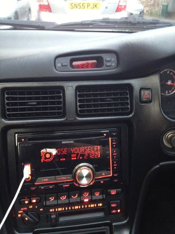

Been on holiday etc a lot recently, but did manage to get this from Magic Beans!
Co-ordination 8) 8) 8)

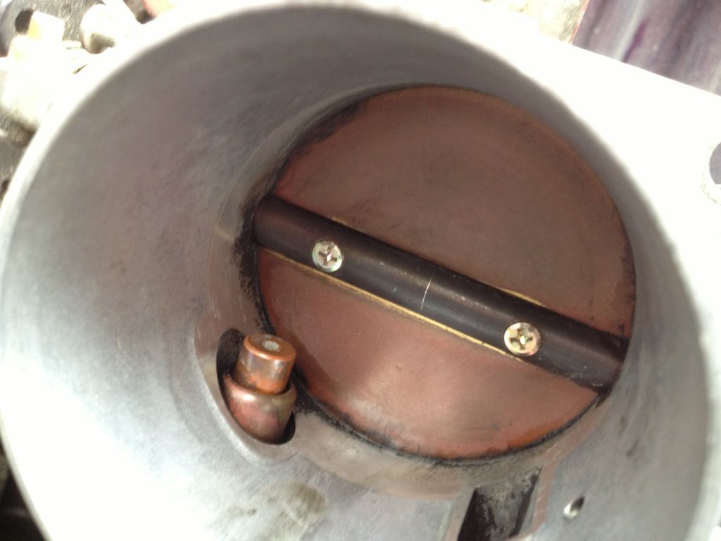

Also... I completed my degree in architecture and have been awarded a 2:1. So I rewarded myself... And bought a supercharger...

I would eat my food out of my throttle body now :D
