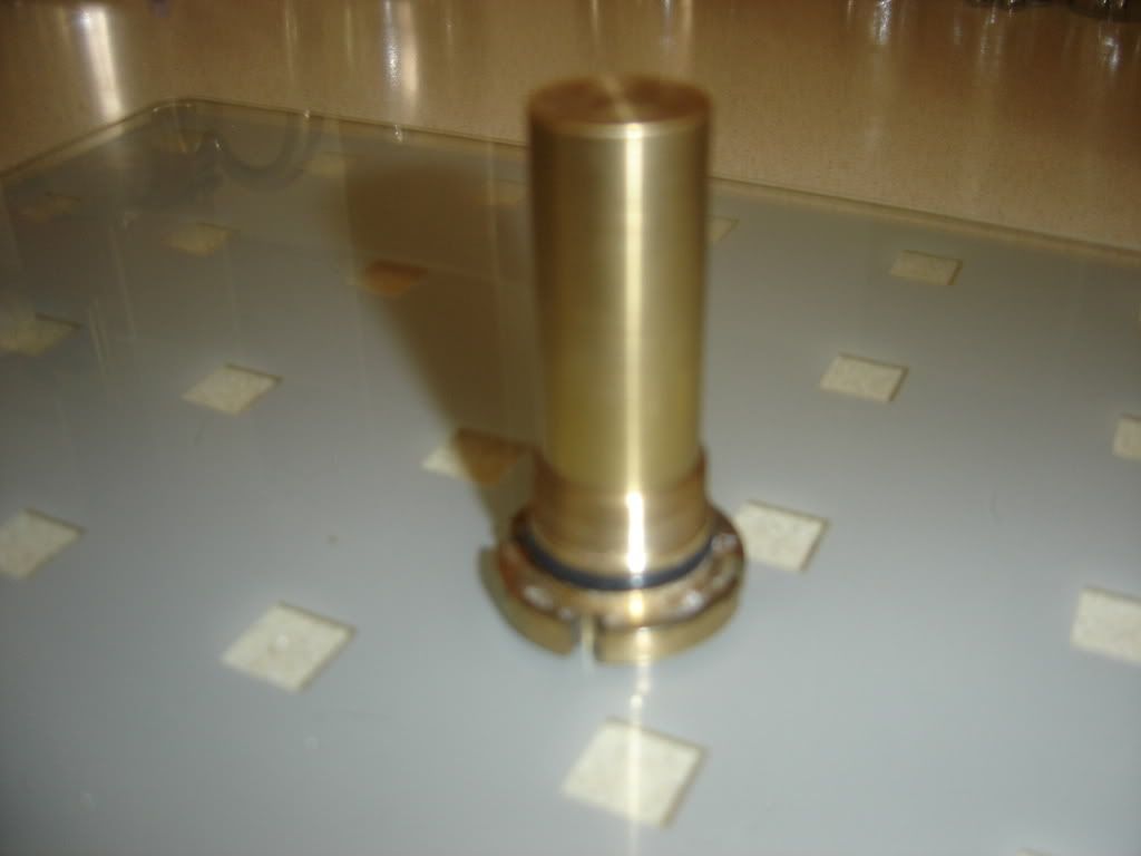

Hey bud be careful if your using aluminium, I thought the tank and the boss might corrode making it unremovable, so went with brass.
If I get a min I will post up a piccy of what it looks like now.

OK serious problem now.... im losing like a litre of water from my chargecooler every couple of days...... the other day i lost all my power and the reading on cooler was off the scale. so drove home nice and slow and found 2 be missing well 2.5ltr of water!!! and just had 2 put another 3/4 of a ltr in, major air in the pipes.
I drilled that hole through the water level sesnor thing so im pressuiming that is the problem? waiting on the new gauges 2 arrive so i can knock up a new alloy fitment at work, if its not that though, could water be leaking into the turbo or throttle body / engine and just vapourising??? :shock:

Well no leaks found, was just somehow low on water....
Well anyhows got some funds so im back 2 the Temp Display lol
Got myself a 2 pod guage A pillar :D
2 gauges otw 1 for oil and 1 for the cooler :D
and making a custom piece 2 fit into the water level sesnor, great being a toolmaker :lol: so that'll seal the leak there, and the gauges are 1/8" NPT thread so will have a tapped hole into that 2 fit the sensor in, had 2 buy a 1/8" tap tho :( as its not a british standard that i could rob from work :lol: but it'll seal or something so it wont leak :D

Rite then, made the adapter that fits the CC, and its awsome!! Doesnt leak what so ever now, tidy bit of toolmaking if you ask me :D Still waiting on the Gauges From Nick..... Im sure it'll work tho, cant wait.
well here is the adapter i made at work,
