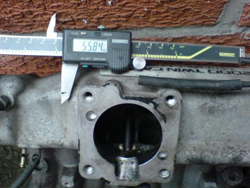

rev2 manifold

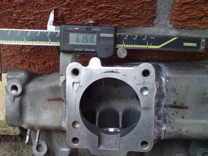

rev3 (mounting welded onto rev2 manifold)
Can't really remember but don't think the holes line up, plus the locating dowel is in a different place.

Cheers. Will i need to do that then, weld the rev 3 flange onto my rev 2 manifold?

Thats what I did anyway. Why do you want to do it? I did it mainly because I have an st205 c/c and it'd be a nicer fit if the sock mounted properly. I did try making the rev3 manifold fit a rev2 head, but I wasn't happy with how everything lined up.
