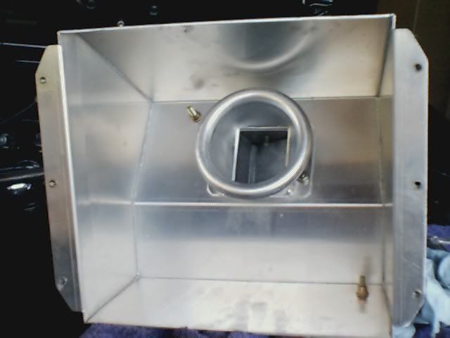

The factory airbox on the MR2 is set up as a cold air intake. I didn't feel any difference with the Biltz SUS that I have on there now. Maybe a little less response. If you're not going over mild modifications just stay with the factory airbox. Those chambers on the box and pipe keep noise levels down and store unused air so you have crisp throttle response. Of course the ARC Induction box does the same and has a velocity stack but do you want to spend that extra money?
mattcambs
Posts: 2308
Re: [Mk2] [Turbo] Stock Air box Vs. Aftermarket
Post by mattcambs »
lostsouljah wrote:The factory airbox on the MR2 is set up as a cold air intake. I didn't feel any difference with the Biltz SUS that I have on there now. Maybe a little less response. If you're not going over mild modifications just stay with the factory airbox. Those chambers on the box and pipe keep noise levels down and store unused air so you have crisp throttle response. Of course the ARC Induction box does the same and has a velocity stack but do you want to spend that extra money?
What's a velocity stack?
This is will allow smoother and even flow through the intake duct.
