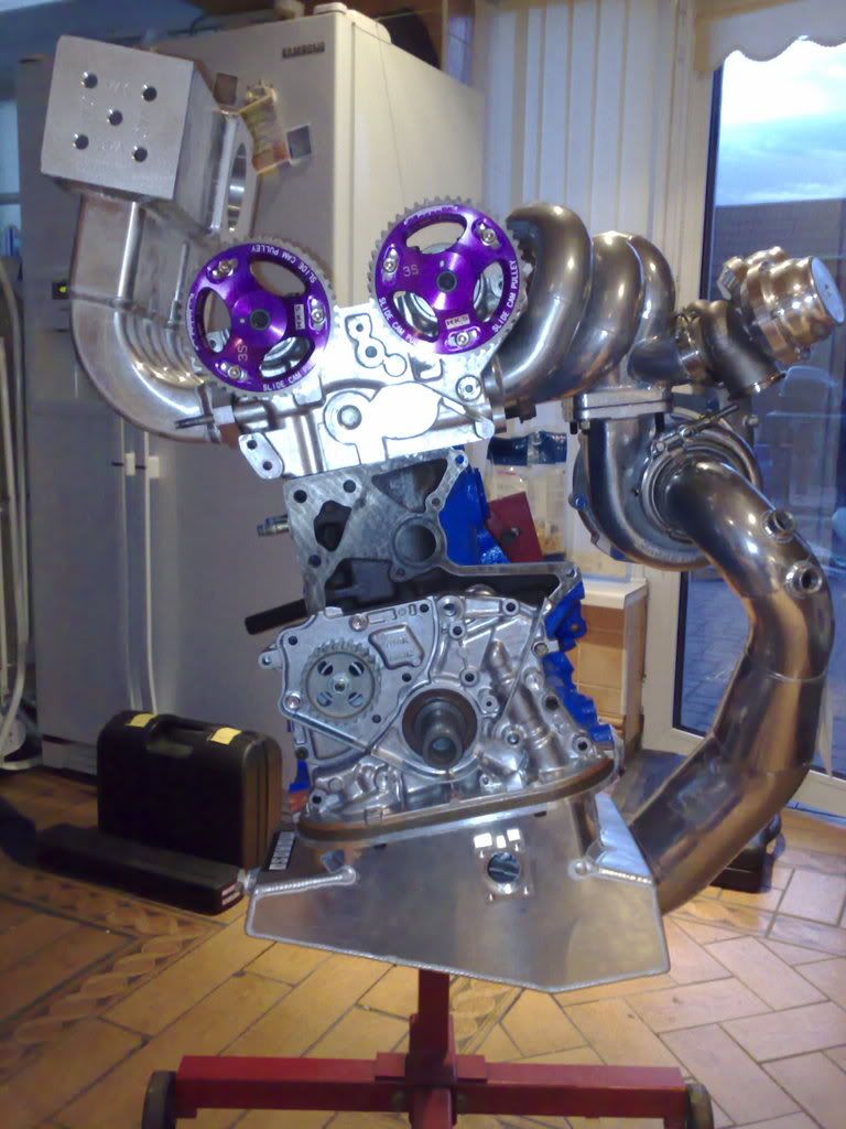

Looks very blong - what's the spec? and are you sure it'll go back in the car with all that bolted on :whistle: ;)

Looks absolutely amazing mate. Did the manifold and downpipe come coated like that or did you have it done? Beautiful!

Thats my worry's! I'm sure it will but i'l find out soon enough - even if it doesnt the sledgehammers coming out to persuade the bulkhead lol
Quick spec hks 2.2 stroker/pauter rods/RMR/GT4094r etc etc..
Edwin,
I had the Hot side of the turbo, the manifold and downpipe ceramic coated :thumleft:

i'm confused tho. whats the deal with the inlet manifold?? intercooler??
its some piece of machinery. is it still a 3sgte under all that?
Thanks :thumleft:
The inlet manifold is from ross machine racing
http://www.rossmachineracing.com/2ndmr2mani.html
Intercooler - i was going to use the radtec, but decided to go boot mount for simplicity/reliability and to free up some space in the bay.
Oh and its still a 3sgte :lol: well the main block & head castings :thumleft:
Just hope it goes half as well as it looks :oops:

can't believe you've not put up a better pic of the tein WG set up!
This is one special set up though you got there Michael.
You gotta love the moroso sump aint ya :D

cantfindausername wrote:can't believe you've not put up a better pic of the tein WG set up!
Didnt know Tein made wastgate setups :lol: :eye:
Just for you ant i'l get ya some better pics up :D
It may look nice, i just hope she runs well after all the work :oops:
The morroso sump is a nice piece of kit, im staying with oem oil cooler so im hoping this will help to keep the temps slightly cooler with the greater amount of oil and with it collecting more air underneath the car :pray:
Just a note about fittment, mine came modified to supposedly clear arp studs on the end main cap, with tysons block girdle the clearances should be the same but its around 3/8" shy of clearing them, so it needs chopping and welding to clear them.
are you on arps main studs? how did you get on?
Michael.

tein, twin, you know what I mean :lol: It was late and my fingers hadn't worked properly all day long :lol:
My sump has the cut outs, but I still needed to take a dremmel to it to clear a bit of material out to clear the ARP mains.
