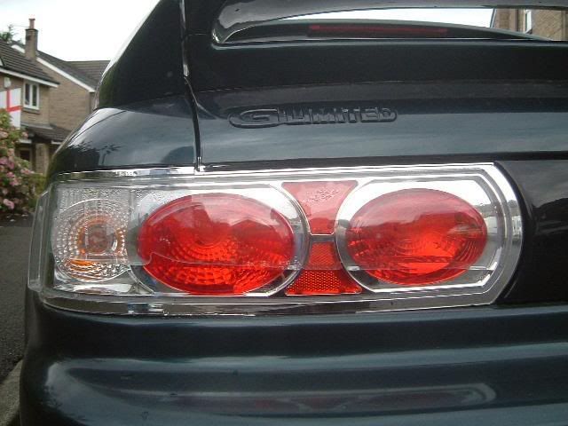

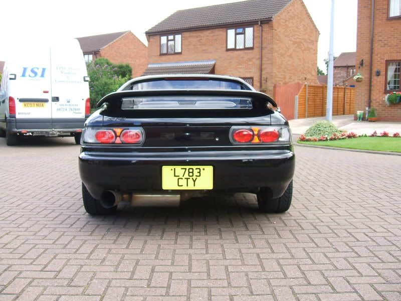

i've fitted black lexus style lights to my car and they seem to be constantly steamed up
anyone know a way of stopping this? putting them silicon ball things in somewhere maybe?
thanks

The only way to do it is remove them, stick them on a radiator over night, make sure they are nice and dry, then use a good quality clear sillicone sealent and run round they entire edge, cleaning any smearing as you go, make sure you go all the way around. Also make sure its good quality sealent so it doesnt go mouldy.
I had to do this to mine, it seems to be a rare occasion that they dont leak, you could have kept goldfish in both of mine. :D

Eventually they look like this. :(
I went to Rev3 lights and binned them. :)
