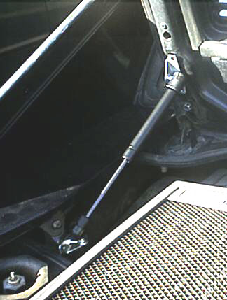

Saw these on ebay think i might get some when i get my mk1, has anyone used/fitted them just wanna know if there good quality etc and a easy fit!! Linky: http://cgi.ebay.co.uk/MR2-Gas-Spring-En ... dZViewItem

I think most people with an MR2 have one of these :lol:
They can be quite stiff but certainly prevent the engine lid on head Scenario that used to occur

Yup, they are good. As Tim has said, quite a few people have had them fitted and they're easy to fit - and very useful as the standard prop for the engine lid is on the wrong side...
(you open the engine bay on drivers side, then have to clamber around to the other side to set the prop up, then more often than not you have to go back around to the drivers side to do the work that needed doing!)

Yup, ive got one on my MK1, had it for about 4 years & wouldnt be without it, \:D/ in fact i normally end up dropping the lids on cars which are not fitted as i get used to lifting it about 1" then the prop takes over :oops: theyre a lot cheaper now than they used to be, in my opinion one of the best bits of aftermarket stuff you can buy :thumleft: . Jinxy

You can't have one of these fitted at the same time as a strutbrace though as the bolts that comes up from the shock assembly are not long enough to accommodate both :(

The twosrus.com engine lid prop fits to a different part of the car Garrick so might be an option. I've got both a strut brace and prop on mine. :thumleft:

Also there's one from a Volvo somethingorother that can be used. Costs an 8th of the ones on ebay :wink:
Tom should have more details.

also got one of these on my SC with a cusco strut brace no probs and got one on my NA and wouldnt be without it and cost is high for what it is I guess but cant be ar$ed with messing about so happily pay that to just bolt it up.

"You can't have one of these fitted at the same time as a strutbrace though as the bolts that comes up from the shock assembly are not long enough to accommodate both"
Well noticed!! I do prefer the look of the ebay one over twosrus.com's version as its available in stainless steel!! Is it not possible to use longer bolts if you wanted to fit a stut brace as well or is that not possible??
