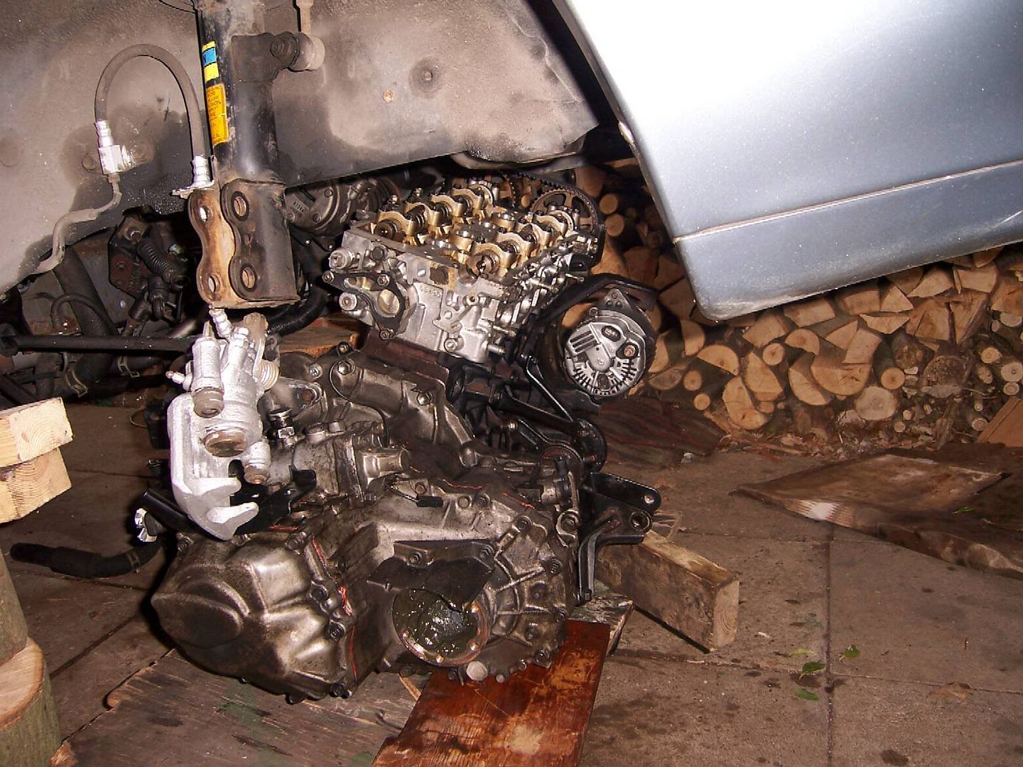

Supporting the car: I supported my car with tree trunks -I kid you not. You can just see them in the left of the picture.
It helps if your Dad is obsessive compulsive about collecting firewood though...

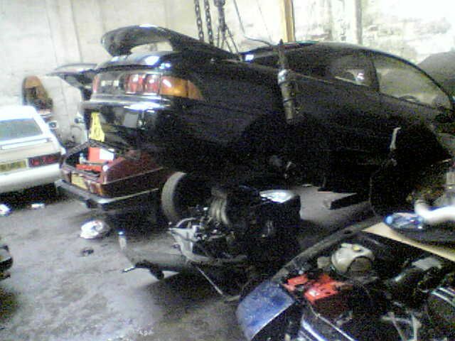

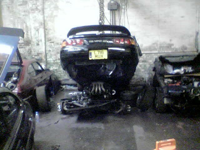

I made 2 plates to bolt in the top of the rear shock towers. An eyebolt through each of these and I lifted the car using a winch onto an RSJ in my garage roof. Gave me plenty of space. Also made a wooden tray on wheels so the engine could be dropped onto it and moved about easily.

Quite handily, my old unit had an overhead 3 phase gantry crane, which made life easier!
I had the front wheels on some metal ramps to clear the front bumber/splitter.

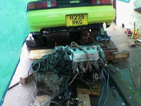

Told you before dude... its all pictured on my site :D
And I also just use normal halfords axle stands. Put the on the jack points and raise them with wood/mdf slabs or what ever else you can find thats flat and sturdy. Its quite scary how high you can get the back of the car with this method.
Also used a clarke 150kg dolley from machine mart to move the engine on a false floor of MDF so it was smooth. Worked a treat.
Then when the engine is back under the car, use the hoist to hold it level (might need a leveler - again from machine mart), then get the gearbox on the dolley, and mate the 2 together. Did it on my own and it made very light work of what could have been a b1tch of a job.
