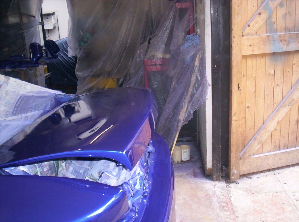

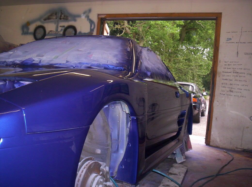

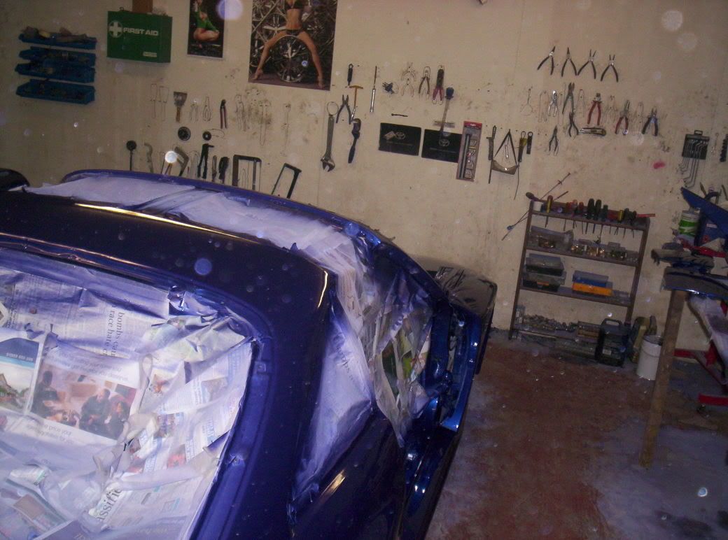

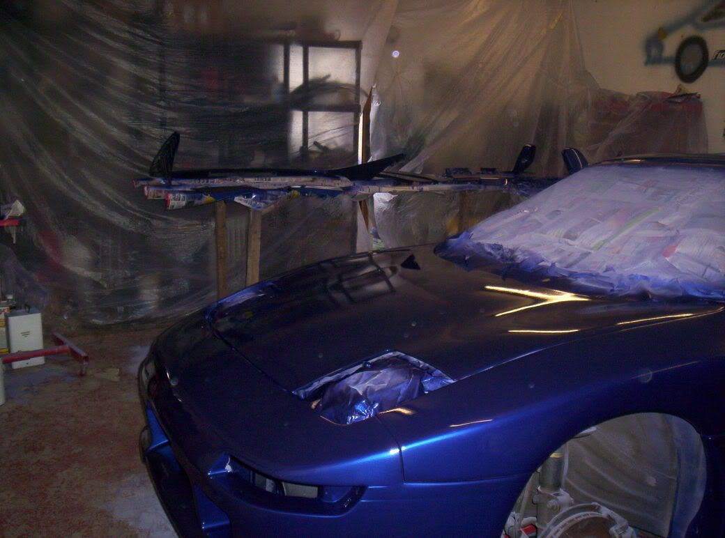

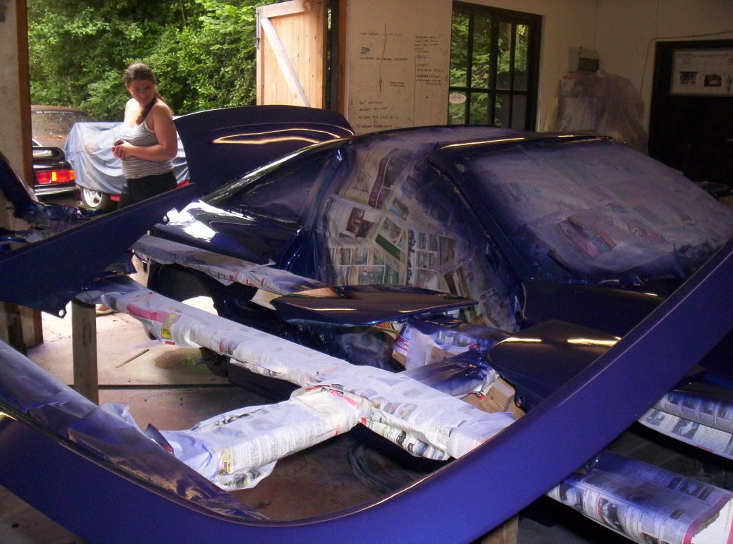

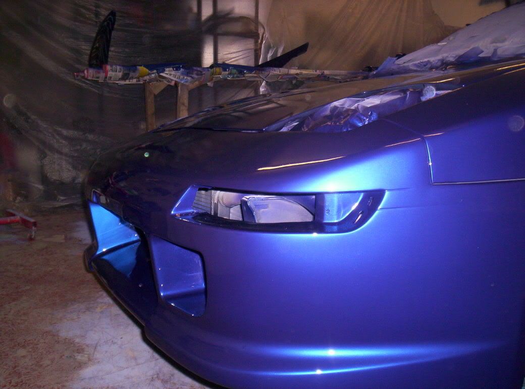

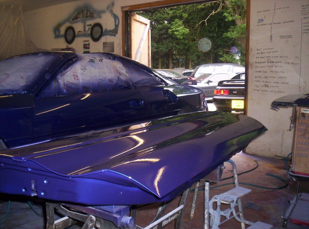

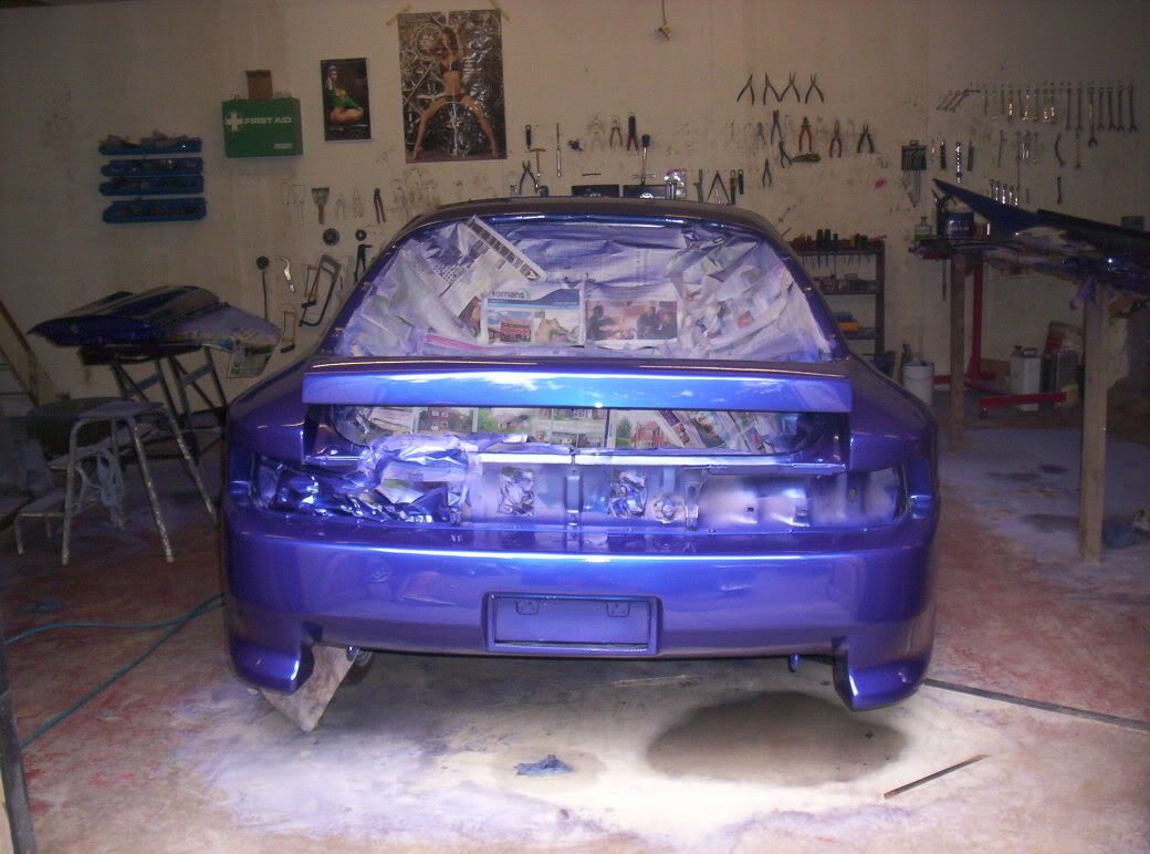

:mrgreen: Be surprised what can be done with some elbow grease \:D/
its got to be polished yet to remove some small marks for particals of dust, buts it aint half bad! :clown:
Re: TRD 2000 KIT
That is one hell of a transformation!!!!! Nice work fella =D> =D> =D> =D> 8)

:mrgreen: looks even better in the flesh, its so shiney all you see is mirror images from every thing around :mrgreen: its still covered in spray dust and needs a polish :mrgreen:
