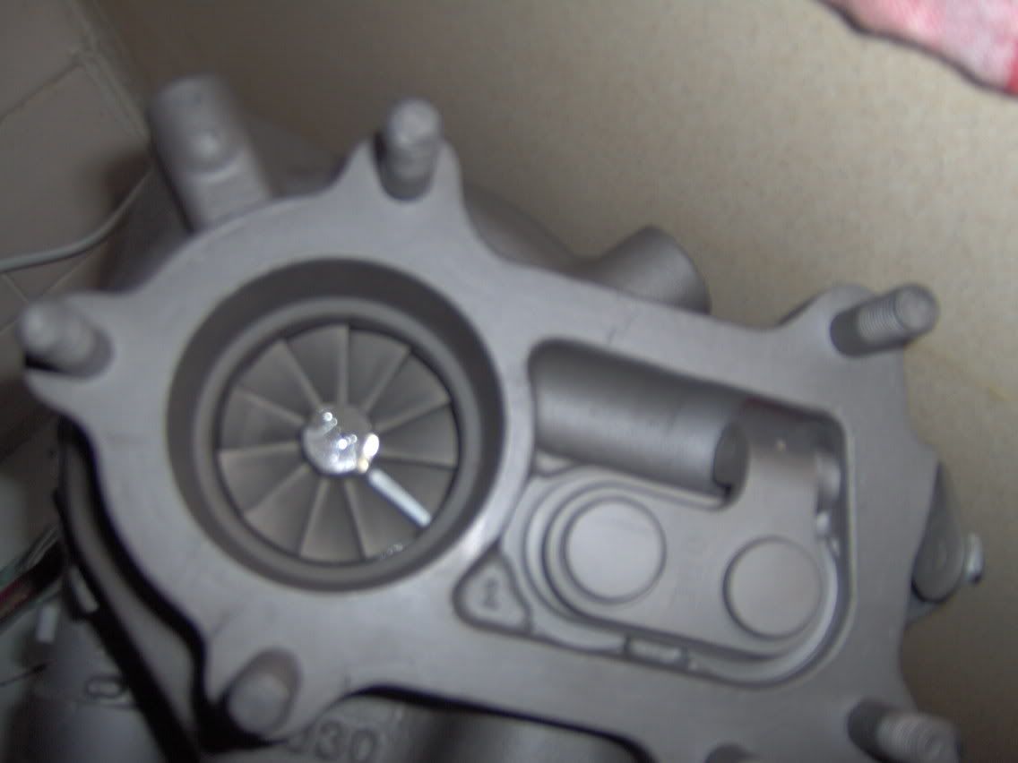

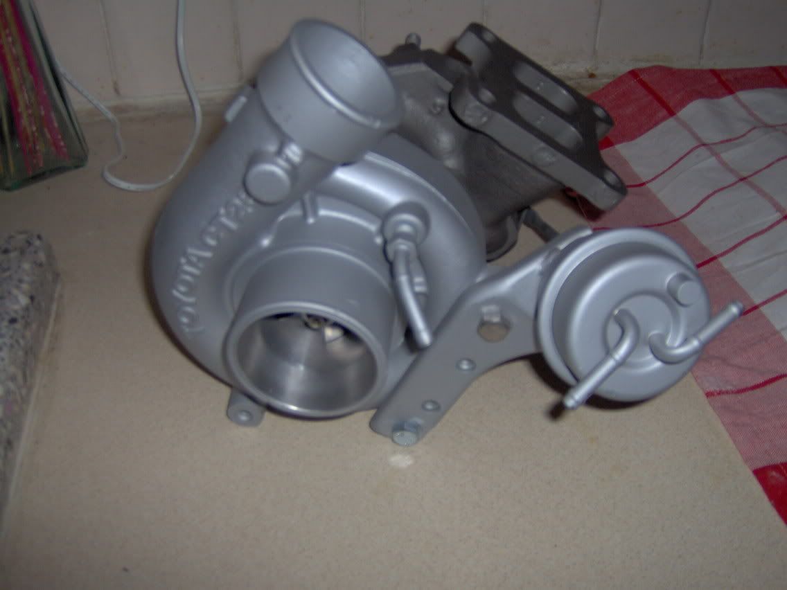

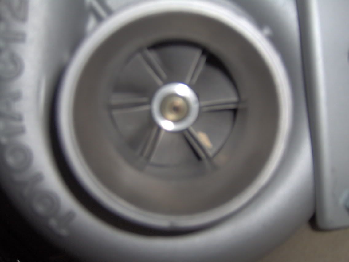

dansREV2turbo
Posts: 1844
Joined: Tue Jul 26, 2005 11:24 pm
Location: wilts
Re: Specs For ATS CT27 Please
Post by dansREV2turbo »
pics of mine before it was installed.hth.

thanks for that, is there any benefit from having the ats over the Turbo technics version, think the TT has a single exhaust port?
any info would be great.
cheers karam
dansREV2turbo
Posts: 1844
Location: wilts
dont know mate, my 27 overboosts in 5th when i get up to around 140mph on my private runway.
